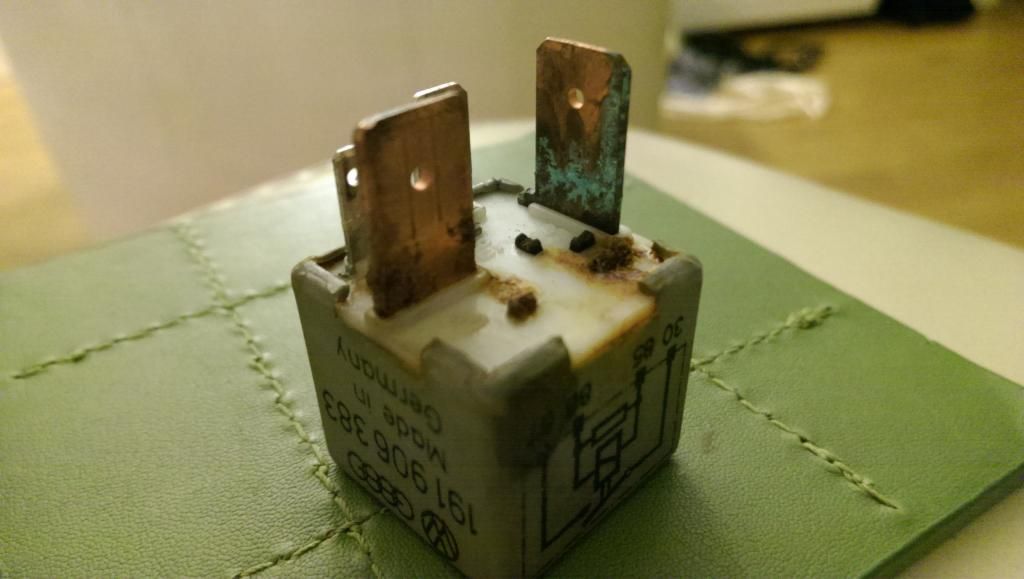

Just had a look and it turns out it's an 80 relay !
Water has been getting in to the fues board.
Replaced it with one I had in the shed fingers crossed it solves the problem
See attached image
