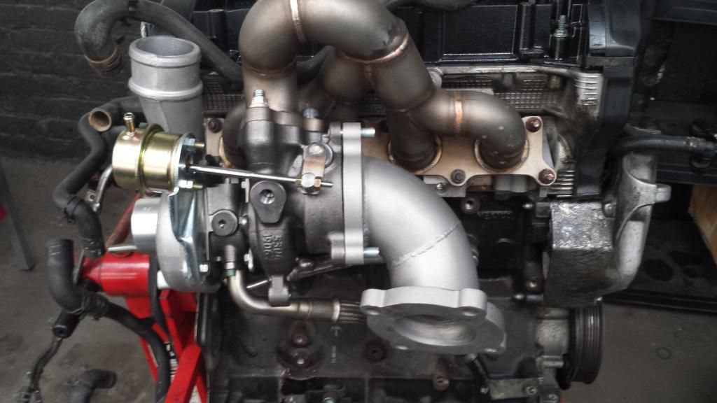

Well my set up at mo
AUM engine
I.e forged H rods
Wossner low com pistons
Flowed head
BBT k418t turbo
Relevantless v4 pro manifold
600cc botch in
Water meth
As it stands good for around 360 ish bhp.
