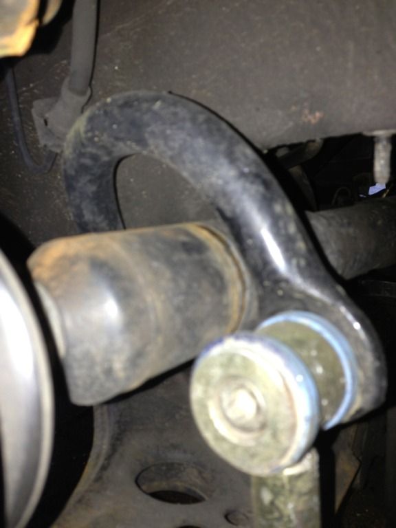

http://www.golfgtiforum.co.uk/index.php?topic=266707.0

not just that it's thinner, the passenger side shaft is shorter so sits at more of an angle than the drivers side
Rio I see your ARB and raise you with this
:grin: :lipsrsealed: Wes more or less how my old one was
