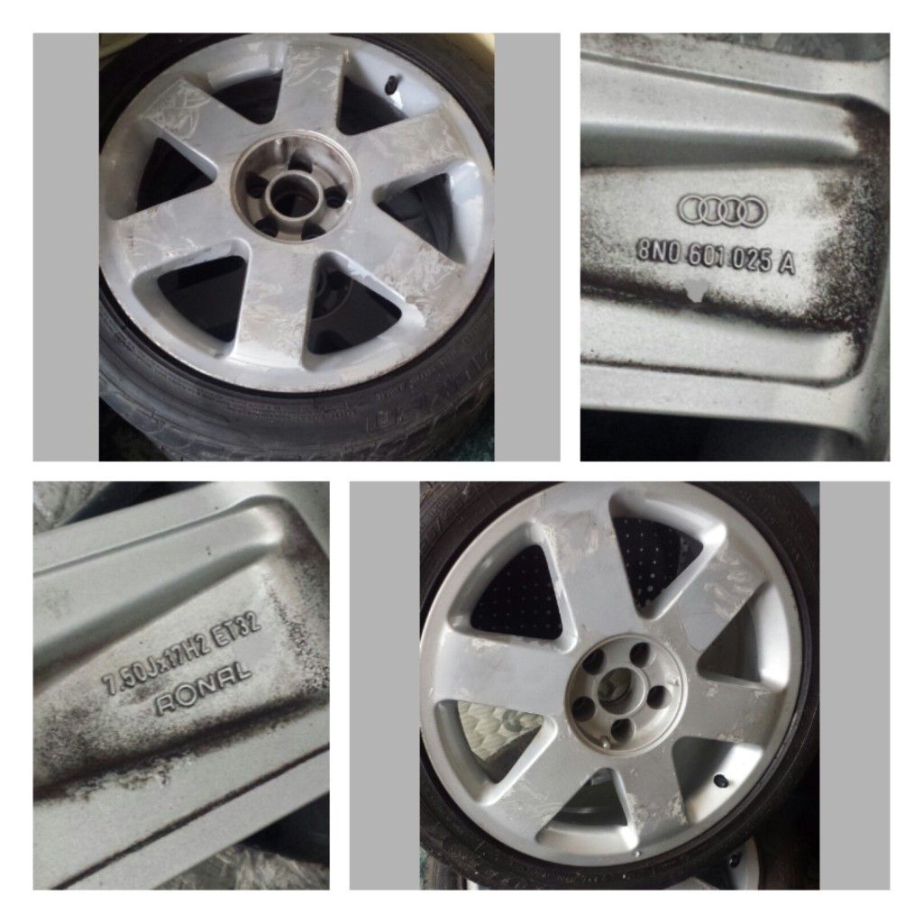

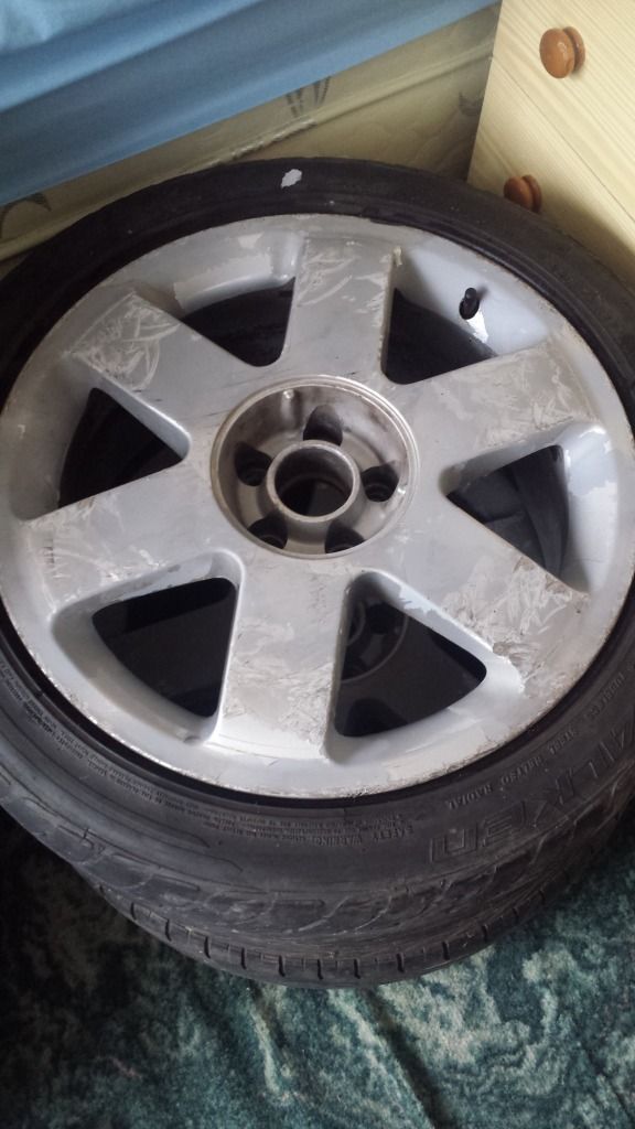

cheers for the info I started sanding them down today id say 75% of the paint that's left is flaking off anyway would it be worth doing in inside too or just the front ? ill add a pic of them as they stand now .
Standard gti 2.0 115bhp 2000 w reg
Offline Mark b
  • Posts: 583
Re: diy alloy referb advice needed please
« Reply #8 on: 24 May 2014, 21:44 »
this is prob the worst I think
Offline MarcIV
  • Posts: 101
  • Mk4 GTI
« Reply #9 on: 25 May 2014, 09:51 »
Nice work!
 If it's flaking, take it off :)
It's totally up to you if you want to do the inside, it gets filthy fast anyway. Unless your like me and you like to take off the wheel and do a long job at cleaning. Then I'd advise it. Or if your choosing a colour like bright pink then I would do the inside :p
