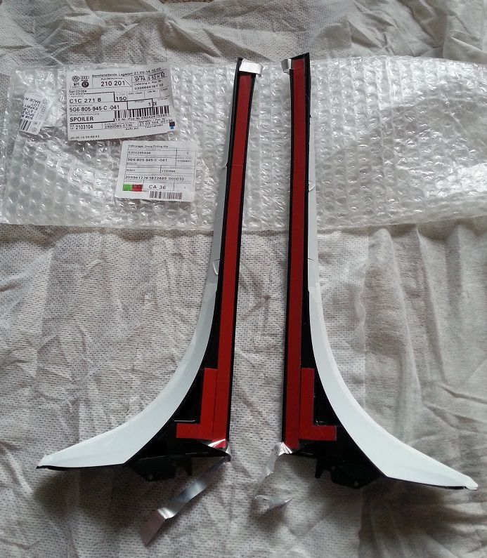

Well today I received my missing trim in the post as arranged by the leasing company. Despite my request, there was no information with the trim on how to proceed. No compliment slip, nothing! I presume they expect me to take it to my local dealer and inform them of the situation so they can fit the trim free of charge.
Looking at the trim though, it's just adhesive pads that literally stick onto the car, so all needs to be done is line it up and stick it on.
Before I do this, has anyone any advice re: preparation of surface before I stick 'em on?

A thorough clean and dry of the area and a wipedown with IPA or panel wipe if you have it would give the best possible adhesion
