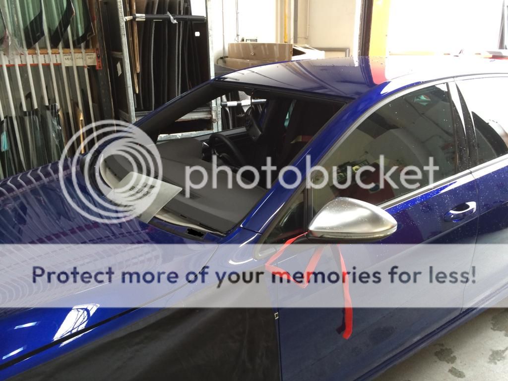

« Reply #26 on: 07 June 2014, 11:40 »
Insurance declined an OE screen even after much moaning and reasons for having an original part!  :angry: anyway, i agreed to have a new one fitted and if any issues arose then we would deal with them.
Went to the Autoglass premises for 8am this morning and after a little mix up with their booking system agreed to get started, a couple of the technicians were looking at the chip and said it should be repairable even though the two 'legs' took it outside the maximum repair size so agreed to give it a go before changing the screen, the repair was done and tbf it was quite a good job and if it had been 3" in any direction on the screen i'd have left it but it just wasn't QUITE right :cry:
So a new screen it is!!
Being honest i'm very happy with the job and it's night and day with the last job i had by Autoglass, the kit he used ensured no damage to the bodywork and he had a brand new gel pack for the rain sensor ready to put in, the screen itself is pretty much identical but has a small Pilkington square logo instead of the VW badge which i think i can live with tbh, all in all i'm happy with the job.
Thanks Neil and Avril at Autoglass :afro:
