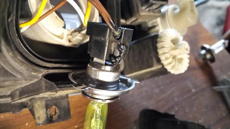

if your buying yellow bulbs off ebay dont buy the 100w ones they melt headlights

Is that because of the poor headlight wiring or the dodgy bulbs.

That is/was perfectly good wiring, that's not designed to carry the extra load of 100w bulbs and I doubt they would have been any brighter, 55w is the max you should use.
