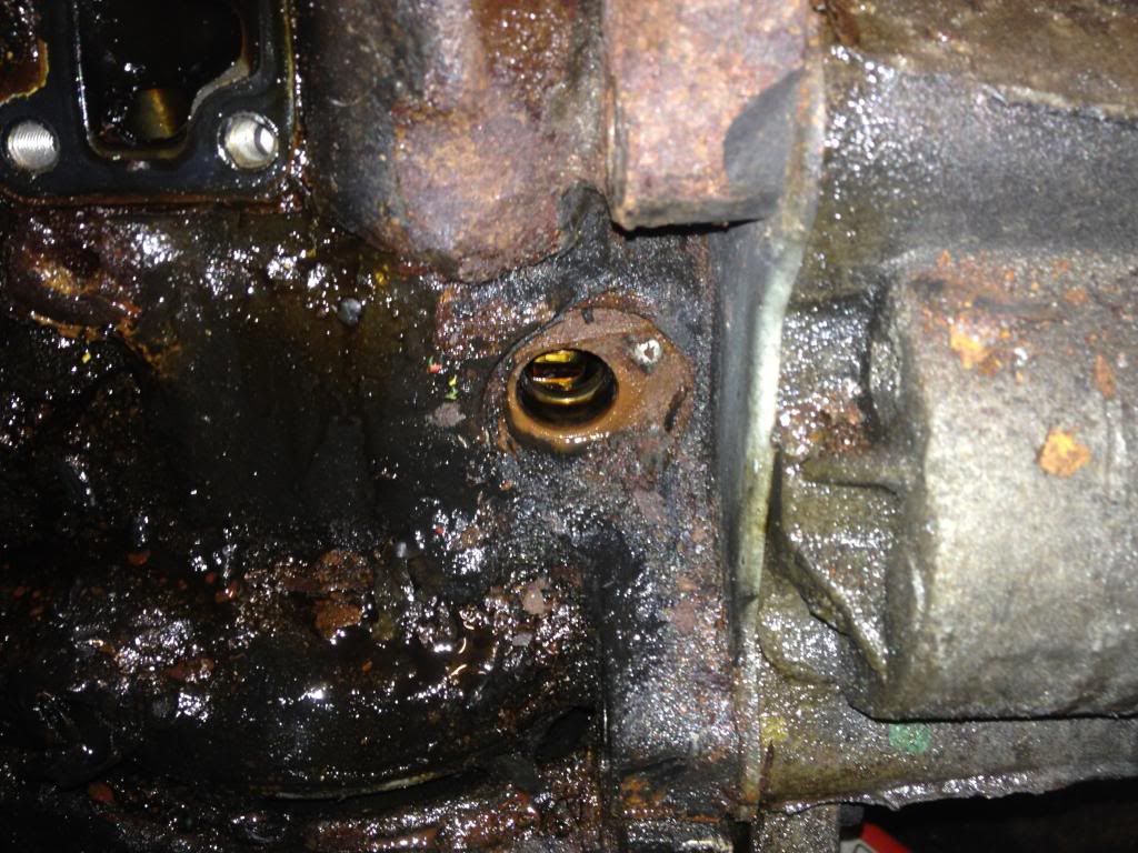

Looks pretty knackered but what is it?
« on: 31 December 2013, 15:00 »

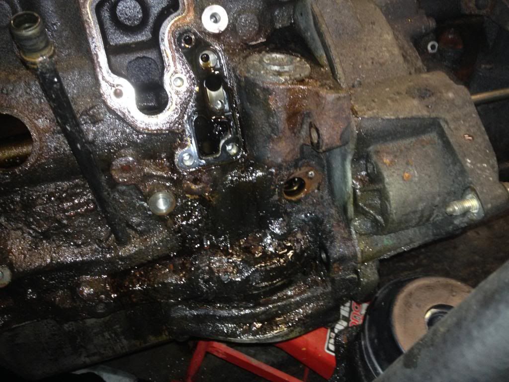

Fits into the crankcase so its oil temperature I think???
Fits here at front of engine behind the main engine mount

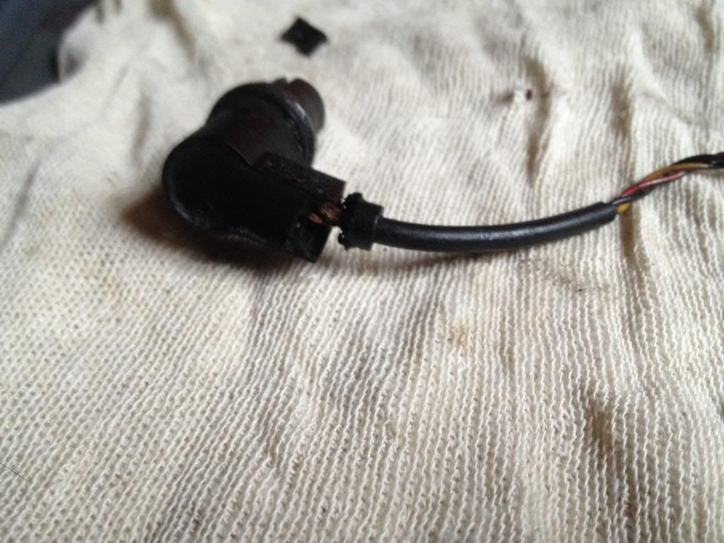

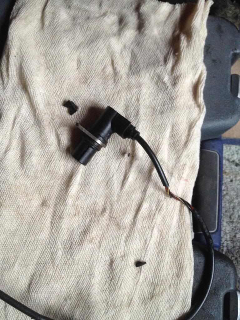

I think that's a crank sensor i had to change mine when car wouldn't start.

If thats what it is then will definitely need replacing!

indeed they are pretty cheap to replace not so easy with engine in but you will have no trouble.
Just a quick question how hard was it to remove your oil heat exchanger thingy to the left of crank sensor oil filter screws onto it.

Bloody difficult!
Its got a thin nut on the big hollow tube screw thread thing that the filter screws onto.
You have to undo that to get the oil cooler off so you can get to the other two bolts behind it.
I am discovering that this is not an easy engine to work on as everything is either obscured or behing something that you have to get off first!
