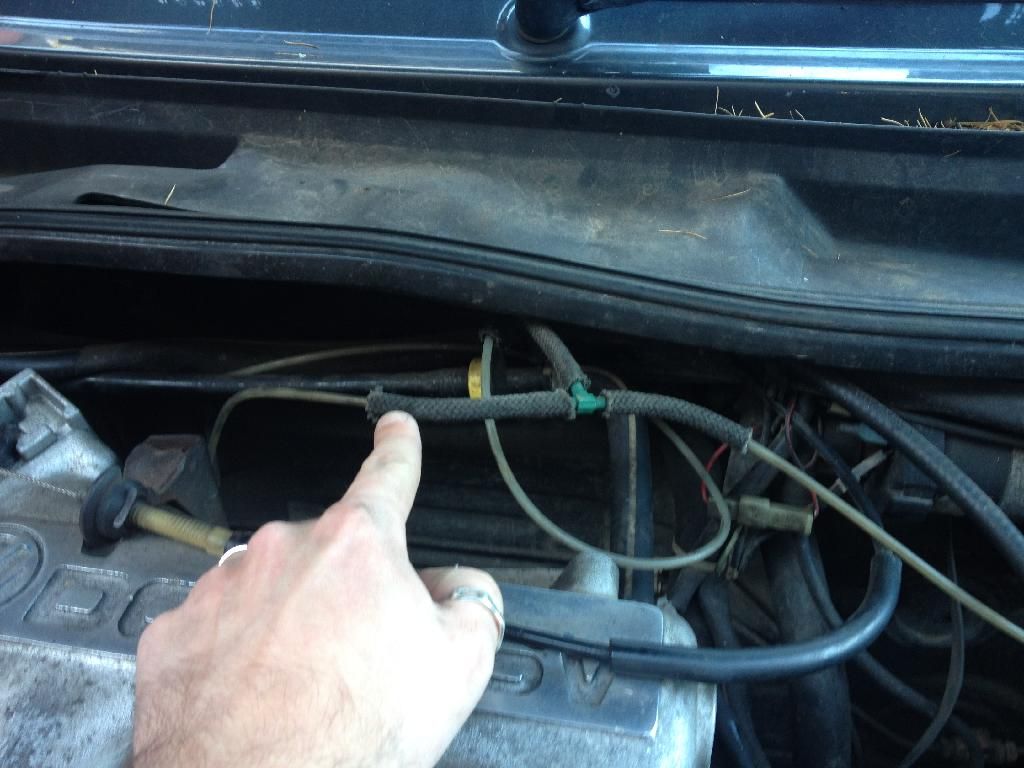

I did find a small air pipe which is disconnected down the back of the engine which I'm not sure where it should go, I'll post a pic...
Basically the pipe I'm pointing to connects under the large plastic pipe that connects to the throttle body. It also t's off and isn't connected to anything.
I guess my next two questions are:
1: should the breather pipe be emitting fuel smelling smoke and can I run it with that disconnected?
(Wondered if a fuel chAnge may help this?)
2: do I need to worry about that small pipe down the back of the engine that isn't connected to anything?

that could be the pipe that's meant to go your mfa on dash clocks. try blocking it of and see how it runs. there should be 4 wires going to your coil. 1 12v feed/2 wires to ignition module and 1 wire to rev counter.

Does your overrun valve have its vacuum pipes all connected? That one looks like its the one that runs to the t-piece just behind overrun valve

Over run valve is all connected ok. This is connected to the same place the over run valve connects to just under the big rubber pipe that goes from the air box to the throttle body.
