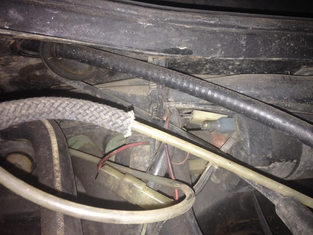

One thing I did notice on the coil is that there seems to be a spade connector fitted to one of the terminals with no wire coming out of it? I'll try and post a pic...

Here's a pic of the coil...
