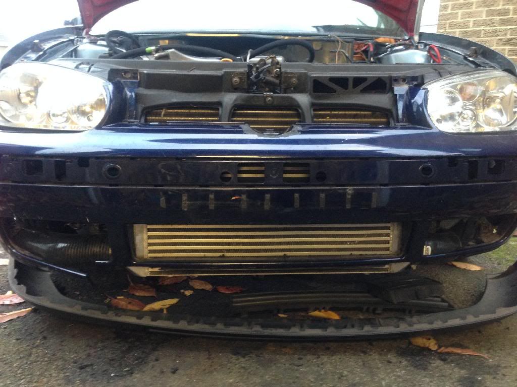

Hi guys at last I have got round to the front mounted intercooler which has been a pain to fit!!!! Got the last bit on tonight and guess what the bumper doesn't fit straight on no suprises there!! Was wandering how people have got past this before or what bits need cutting exactly??? Any ideas anyone :)

Can't upload any pics which is annoying!! But I've had a look and the main problem is that where the bumper bolts on underneith with two 30T torque bolts the pipes sit right in the way! If I get an R32 front bumper will this solve my problem you think?

I had to cut loads off my bumper. I had problems fitting the splitter aswel, it's only temp until I fit new bumper.

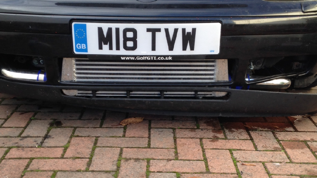

Here is mine:
The back of the bumper needs a bit of trimming, as do the vents. Kit can be found here:
http://www.onlychargeddubs.co.uk/products/1-8t-mk4-golf-platform-front-mount-intercooler-and-pipe-kit.html
