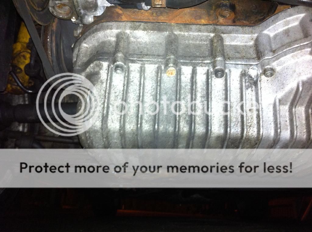

Shame its not got the manifold part aswell its proberly a aftermarket option from a dealer at the time get it dyno'ed it should produce 175 185 BHP if its had all mods other wise its just a oettinger head still oettinger but was fitted at dealers instead of an original Oettinger workshop.
Oettinger 2000E/16v from dealers I think don't take my word its been awhile since I've seen one.
Check the oil sump and show me a picture please?

The sump is different to standard 16v. I'm going back today to I finalise the deal and arrange collection in the week so will get loads of pics.

Very hard to say as most people bought badges over the years and sold them the only one I've seen is the glove box one it has Oettinger next to the 16v gti.
The sump should have long alu fins.

Here's a few pics of my engine.
Sump looks different to other mk2s
