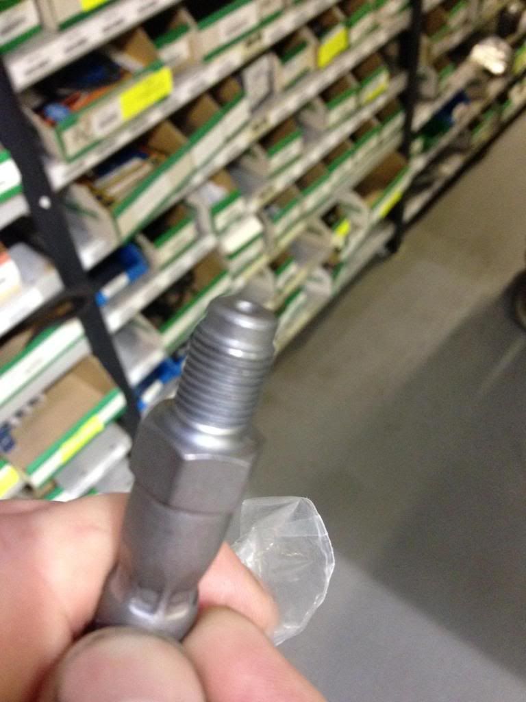

I've just gone out to the warehouse to look at our hoses. We have ATE and a Meyle branded items in stock, I will post the pictures in a sec...

Thanks Ben I need a photo looking down the end of the male end to see if its concave around the bore or a flat end , that is the issue .

Right, crappy picture but this is an ATE hose and it's flat at the end with a smallish hole....
This is a Meyle hose, concave at the end with a large hole...
