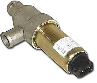

We call it ISV (Idle Stabilisation Valve)
Like this? If it is look at search and type ISV issues or rough idle or erratic idle

this is one i am talking about. ISV, well ICV was close enough, as it stood for idle control valve. but stabilization and control are quite similar.
thanks, i'll look it up

One point to remember they are made in 8V form and a 16V version. NOT interchangeable borrow one and see if it helps before spending monies  :wink:
