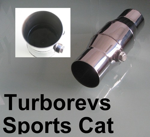

Hey guys, After speaking with GTI_James about this for ages and hearing a video of his setup I have decided I will be doing a turbo back however Im worried about the whole No cat no MOT crap and I don't want the hassle of putting a cat on every MOT.
My plan was to first get these two..... Same as James.
http://www.ebay.co.uk/itm/200627087327?ssPageName=STRK:MEWAX:IT&_trksid=p3984.m1423.l2649
And then...
http://www.ebay.co.uk/itm/230830744910?ssPageName=STRK:MEWAX:IT&_trksid=p3984.m1423.l2649
But now I want to get a sports cat, I have no idea abot these things I.E what is a 200 CPI & 100 CPI cat?
I.E...
http://www.ebay.co.uk/itm/VW-GOLF-BORA-1-8T-20v-STAINLESS-STEEL-200-CPI-SPORTS-CAT-PIPE-EXHAUST-DOWNPIPE-/230863358957?pt=UK_CarsParts_Vehicles_CarParts_SM&fits=Model%3AGolf
|Plat_Gen%3AMK+IV|Cars+Type%3A1.8+T&hash=item35c0874bed
VS
http://www.ebay.co.uk/itm/SEAT-LEON-1-8T-20v-STAINLESS-STEEL-100-CPI-SPORTS-CAT-PIPE-EXHAUST-DOWNPIPE-/230857726895?pt=UK_CarsParts_Vehicles_CarParts_SM&fits=Model%3AGolf
|Plat_Gen%3AMK+IV|Cars+Type%3A1.8+T&hash=item35c0315baf
I have also noticed that the Downpipes with the cats are 2.5" where as the decat is 3" i need some expert adivse here guys
Should I just get the 1st downpipe and then this?
http://www.ebay.co.uk/itm/2-5-EXHAUST-STAINLESS-STEEL-200-CELL-HIGH-FLOW-SPORTS-CAT-CATALYTIC-CONVETER-/330903127722?pt=UK_CarsParts_Vehicles_CarParts_SM&hash=item4d0b5d06aa
But then again would it fit on the 3" downpipe?

Sorry to jack your thread but what does it mean by 200cpi and 100cpi.... Ie what's the difference??

if you are worried about it bud what i'd suggest doing is only getting the cat back for now with a reducer so that it will slip straight onto your current stock dp and cat
then in 2 months time you would of saved enough for the miltek sports cat and that way your guaranteed quality?

CPI= cells per inch, higher the number the more cells there are in the cat. So a 200 cell would give you better emissions, a 100 cell cat would be less restrictive (bigger gaps between the catalyst medium)

CPI means cells per square inch. So the lower the number the less surface area you have for the gasses to flow past. In effect this means the more CPI you have the cleaner the emissions but it also means the gasses will be more restricted

Good point james, all i want to know is if i buy the 3" how would i get the sports cat to fit?

100CPI won't pass MOT
