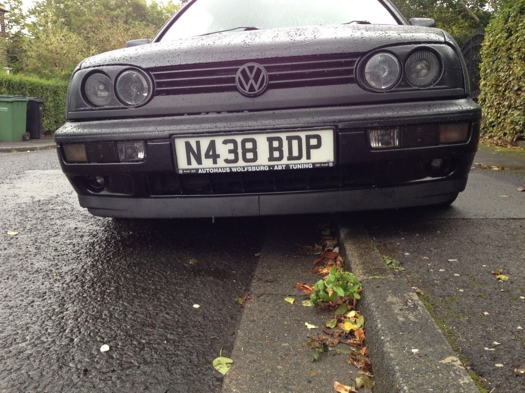

i brought some of those lower air intake/brake cooling things for the lower bumper and havent installed them yet. i got some 100mm wide pipe to run upto the air box but theres not alot of space for it all.
im wondering weather to buy some smaller diameter piping, i belive i need about 80mm wide to fit the vent, or if its even worth the hassle. i dont particularly like the looks of the things lol, but got them for the air benefits but do they really make enough difference to buy some more piping?
