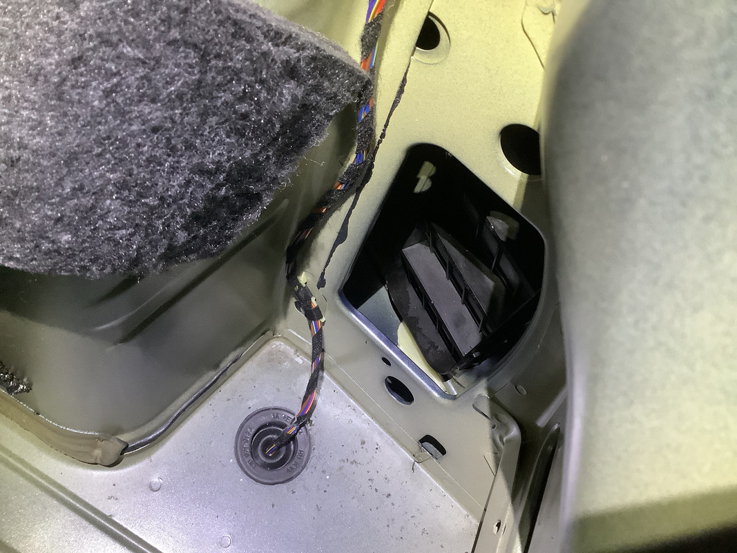

Today I discovered why my spare wheel was swimming in 30mm of water!
And why my windows mist up whenever the sun shines.
History; I have had this car from new, paid cash almost £30ks worth, added tons of extras including leather seats, +£400 on detailing, it has been the second love of my life.
Always serviced by VW and never a single problem...........until now!
Online search indicated rear light seals or air vents (?) hidden under the wheel arches (er why ?)
Now I am a qualified mechanical engineer so I set to work removing interior trims, plug in connectors, etc.
Result; a 25mm pool of water sloshing around in a cavity between the outside and inside corner panels, directly below one of these air vents.
Wait it gets worse much worse, because VW were aware these vents leaked water. YES VW KNEW THESE VENTS LEAKED WATER - FACT!
How do I know? Because an attempt had been made to seal the floor panel below the vents....with wax! YES Liquid wax had been poured into the cavity in an attempt to seal it.
Worse - there is nowhere for this water to drain but into the area under the hatch floor, soaking into anything it contacts.
Top - a piece of the wax I melted and smeared to prove to myself exactly what it was.
Below- the cavity drained of water.
Please note;
a) the partial layer of wax in the bottom, a piece was broken away and was floating on the water before I drained it.
b) bottom right, the muck line cause when water drains from a hole in the cavity out onto the hatch floor.
c) the grey air vents (4) simple paper thin flaps that allow water into the car. The black moulded frame is so poorly made it rattles!
If anyone can explain why I should not permanently seal these vents would they please reply.
Thank you all.
Thank you all.
They are air equalisation or pressure release vents. There’s been a few instances reported on various forums of these failing and allowing water ingress if the vent assembly no longer makes a watertight seal with the aperture in the lower quarter body panel that it’s fitted in.
When you close a door or the tailgate, the vents enable air in the cabin and / or boot space to be expelled to the outside through the vent flaps, so the doors / tailgate can be closed without having to use unnecessary force. If you completely sealed up the vents, air in the cabin wouldn’t be able to escape and I dare say it might become quite difficult to close the doors / tailgate without having to slam them fairly hard, and possibly take a number of attempts before they’ll shut.
The usual fix if they fail is to replace the vent assembly or apply some sort of flexible waterproof sealer to the edge where the vent assembly makes contact with the bodywork. For a VW dealership to attempt to repair with wax is a total bodge job and completely unacceptable IMHO  :shocked:  :angry:.
