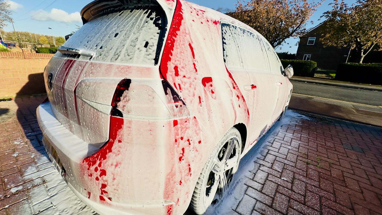

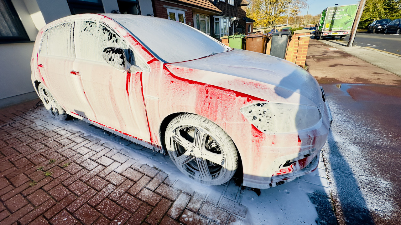

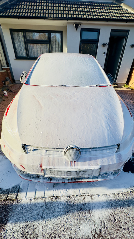

Decided to give her proper wash, First wash since I bought her.
Weather been typical, as it was bit sunny today so gave her proper wash..
