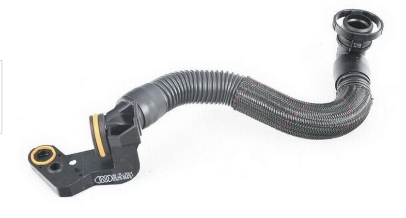

Put a new coil pack on cylinder 4 as it was misfiring reducing mpg, cylinder 3 has a very slight misfire but not frequent enough to warrant a new coil pack will replace all 4 next time it gets spark plugs as parts department told me the mqb coil packs don't like being removed.
Also fitted the squeezy PCV breather hose to the turbo elbow, to avoid having to ever deal with that connection ever again...

Offline willni
  • Posts: 1,478
« Reply #13056 on: 24 July 2023, 22:08 »
Willni
What's the part number for the PCW breather pipe please?
Also, where did you get it from?
Many thanks
Got it off eBay - part number 06K103213J would definitely be cheaper from VW but eh.
Offline clubsport
  • Posts: 874
« Reply #13057 on: 25 July 2023, 09:48 »
What is the benefit or advantage of this breather pipe over the standard fitment?
Thanks!
Offline willni
  • Posts: 1,478
« Reply #13058 on: 25 July 2023, 10:28 »
Thanks!
It’s the pipe with the squeeze connection to the turbo elbow, no other difference. Just did it for handiness.
