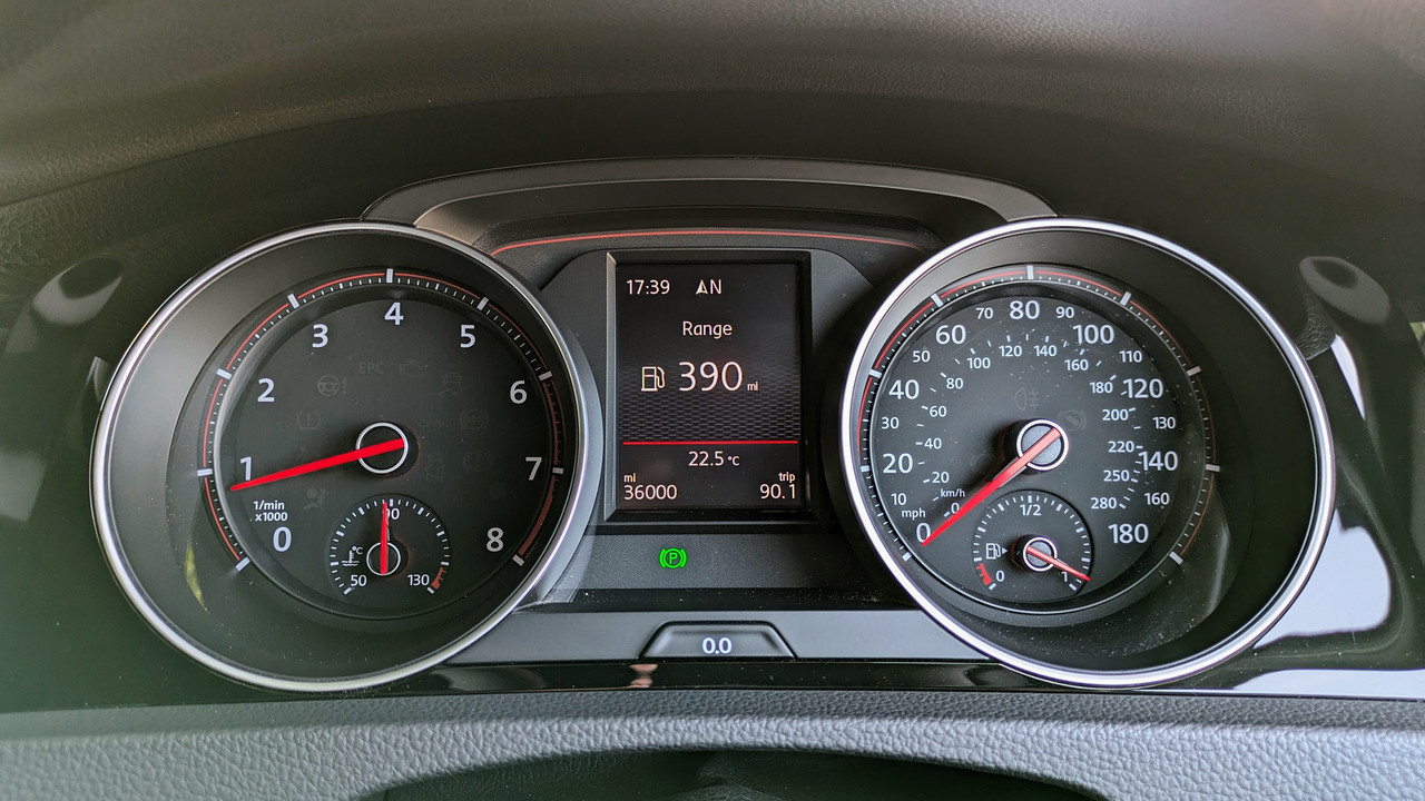

Reached 36000 miles this evening...  :smiley:
Golf GTI CS40 #010 | Manual | 5 door | Pure White | Car-Net | 90% tints | Winter Pack | REVO stage 1
I know I'm in the minority when I say this but the normal dials and needles look far better than the digital dash.
