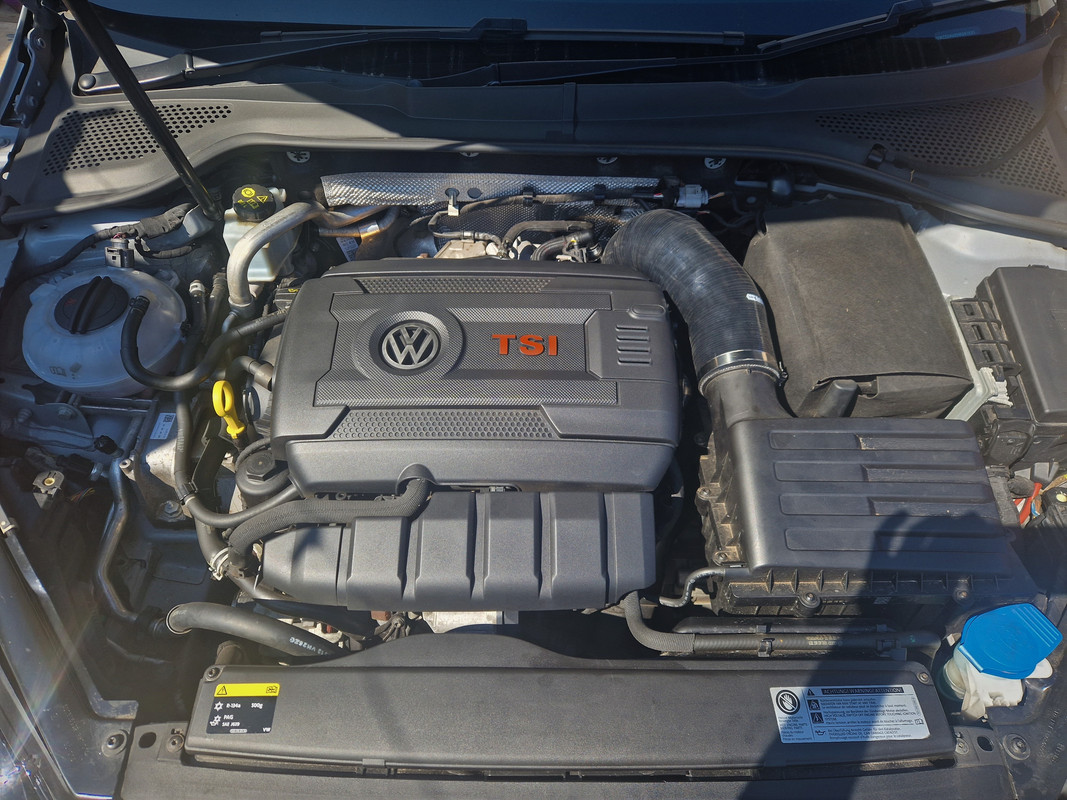

Offline ES98
  • Posts: 8
« Reply #12979 on: 03 June 2023, 15:46 »
I fitted the MST intake hose and turbo elbow this morning. Cant feel any difference when having a quick drive afterwards, but supposedly will make a difference when I decide to get the car mapped. Easy to install, only took about 20 mins and fit perfect. Next job is to give the engine bay a clean.
