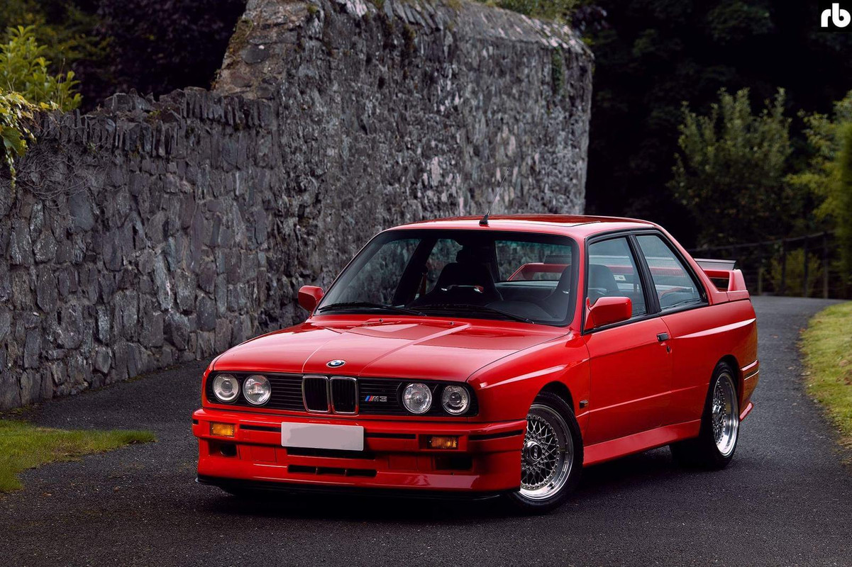

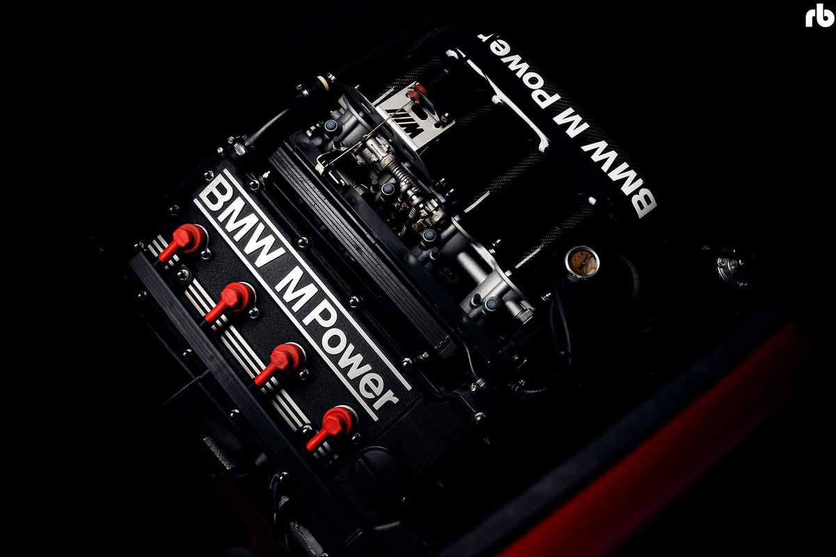

« Reply #11603 on: 12 August 2021, 14:59 »
Booked the car in for some window tinting and I'm very tempted to book a photoshoot for it as well, after having one the other night for another car.
Teasers below not Golf related though.

« Reply #11604 on: 12 August 2021, 16:24 »
Nice! A *proper* M3 (?)  :cool:

« Reply #11606 on: 12 August 2021, 17:58 »
It is indeed (credit to https://reinisbphotography.blogspot.com/ for taking them.)
Offline clubsport
  • Posts: 874
« Reply #11607 on: 12 August 2021, 18:06 »
Nice E30, it has the appearance of a Sport Evo, is it a real one?
(as in a modified/upgraded E30 M3)
