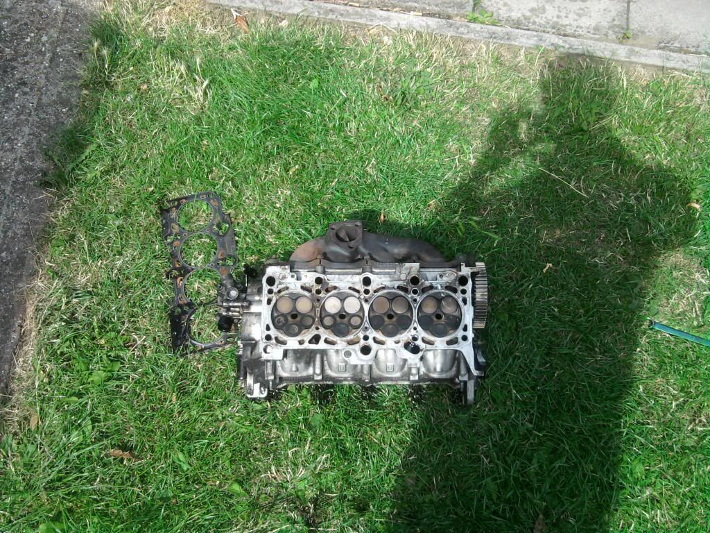

Well today I started on my mates Mk4 Golf 1.8t.
It suffered a head gasket failure at the rear of No. 4 cyclinder causing a huge oil leak between the block and head.
once the head was off it was clear where the failure was as there was also oil on top of the piston crown.
The plan is to fit an AGU head and either a standard K04 or K04 hybrid depending on the funds he has to spend.
So today I went round to strip the head off for him.................

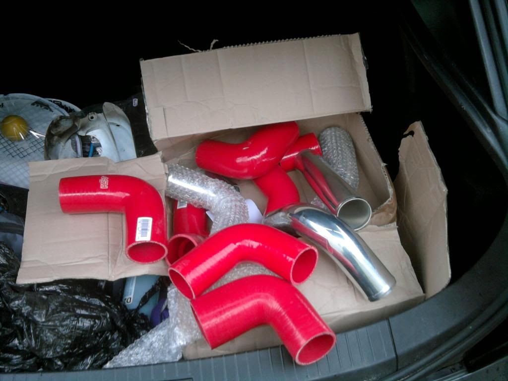

So I got straight on the phone to http://www.autosiliconehoses.com/silicone-hose-shop.html  and ordered all the pipe work for the Welly cooler.
a day later and this lot turned up at my work
So the parts collection is growing, I have just finished rebuilding the head and hoping to have if fitted to the car over this weekend along with getting the new water pump and cambelt kit fitted.
