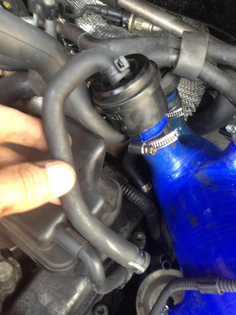

It's a aum engine if that makes any diff
Get a picture up as yours will be the same as the pictures above
Edit : sorry saw your picture ,its still the same size so force it on .  :evil:

« Reply #11 on: 28 July 2013, 21:23 »
This hose
The top tube looks lose so someones put a zip up tie on it, Get some new color silicon tubbing.  :wink:

« Reply #12 on: 28 July 2013, 21:34 »
The metal pipe is twice the. Size of the nipple on the top of the DV...also I'm a little confused as to why dom's hose goes to under the inlet andone don't??

« Reply #13 on: 28 July 2013, 21:39 »
I know, it's because I have removed my N249 and N112 valves :embarrassed:

« Reply #14 on: 28 July 2013, 21:43 »
On mine the hose from the top of the valve runs down to the inlet, the one from the side of the valve runs to the pipe you are referring to, I think that is 6mm ID, not 100% sure though.
You must of removed your metal tube that connects your dv to the inlet manifold. Its bolted to your engine with one rubber pipe off it to the inlet manifold and on the other end of the metal tube a rubber pipe to the top of the dv.

This is how it was when I bought it..should I just get a longer piece of hose and leave it how it was

« Reply #18 on: 29 July 2013, 18:58 »
Sorted just got a bit of 6mm Id hose fits lovely and no more turbo flutter :laugh:
