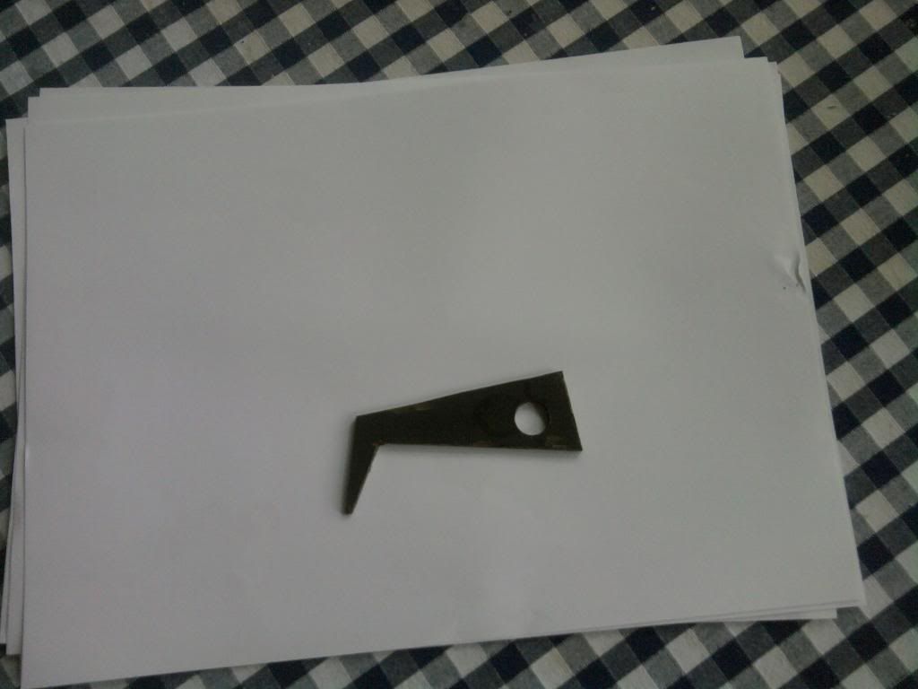

hi,is there a way to lock the engine on mk1.4 golf, need to lock the engine so the engine doent turn whilst undoing clutch, thanks

I made a little hook out of some metal,
Basically bolted to the block with a gearbox bolt and the hook would sit in the ring gear locking the engine.

Here is a picture of it.
One of the most useful tools I have, Have used it countless times removing and fitting flywheels
