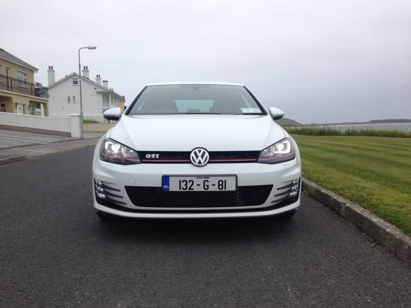

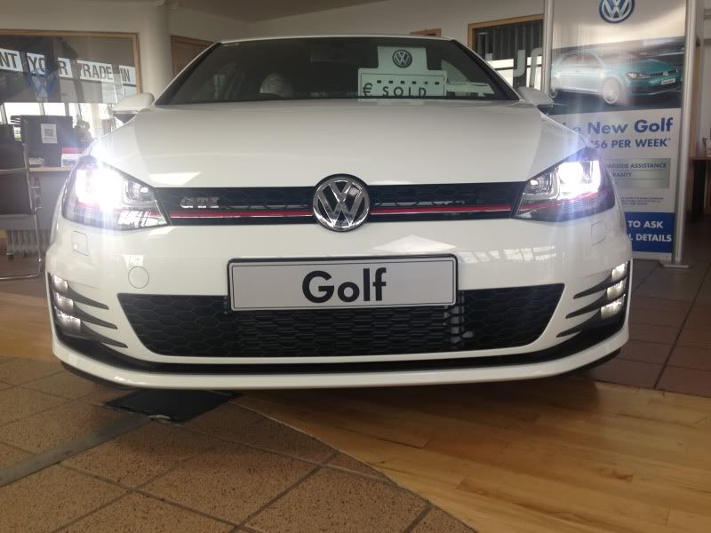

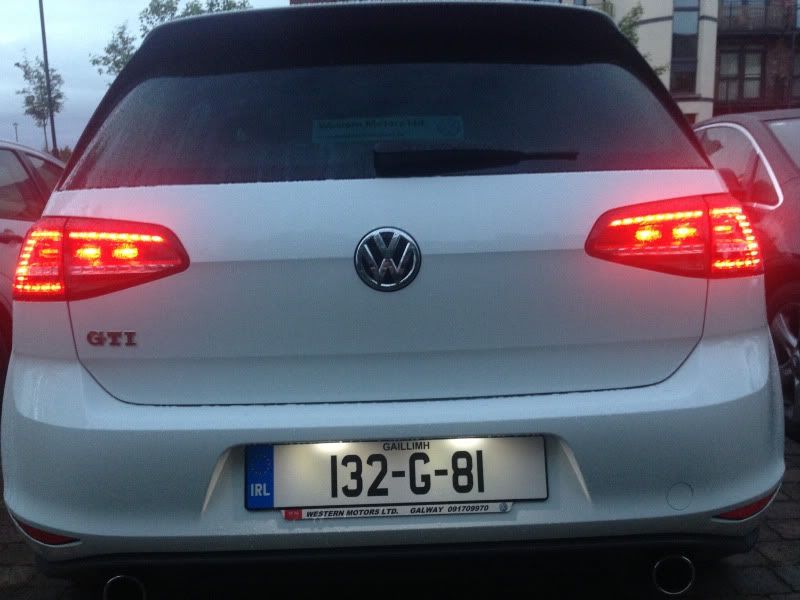

Joe, any chance we can see some from and rear photos of your GTi all lit up?!  :smiley:
Posted before, but here you go!
Offline iainmac
  • Posts: 62
Re: Bi Xenon headlamps
« Reply #5 on: 15 July 2013, 18:51 »
Oops! Never noticed before.  Looks awesome - thanks!  :smiley:
