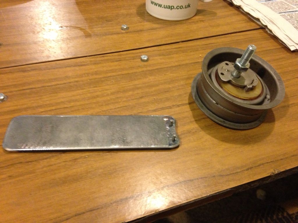

right made myself a little tensioner tool :)
my only question is how do I know how much to tighten the cambelt? don't wanna over tighten.

Automatic tensioners can only go round as far as the lug allows,  just pull it round until it stops and tighten it up.
