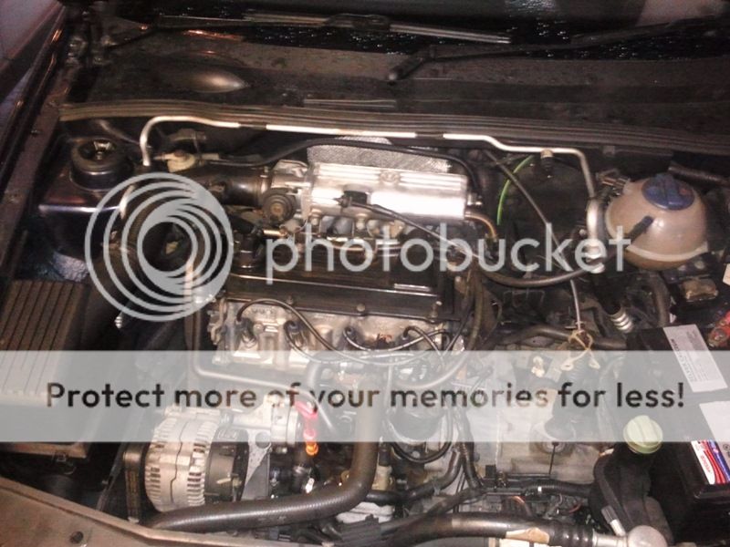

what's the engine code then?
post a photo of the engine too.
I got access to vw repair guides so can look up non-euro models too ;)
2019 Seat Leon ST FR DSG 135kW - eclipse orange - 23k miles

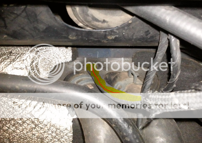

« Reply #5 on: 03 June 2013, 12:08 »
It's an AFV motor according to the engine number.
When you say Vacuum tube, please don't tell me you are talking about this one..
The previous owners mechanics managed to snap the white plastic pipe which the vacuum hose connects to and I have no idea how to fix that either without removing the entire dashboard.

« Reply #6 on: 03 June 2013, 18:29 »
yeah would check that yellow tube!
why do you need to take dash out? probably it goes to the ECU which lives just behind the bulkhead. all you need to take off is the plastic trim just under windscreen wipers.

« Reply #7 on: 03 June 2013, 19:09 »
Last time I tried to trace that pipe and I had the scuttle trim off it seemed like it went underneath that area and into the car itself.
Unless I missed it when I was looking..
