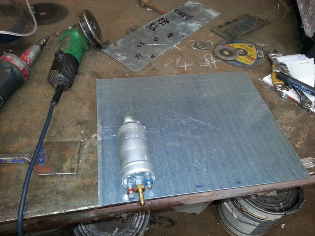

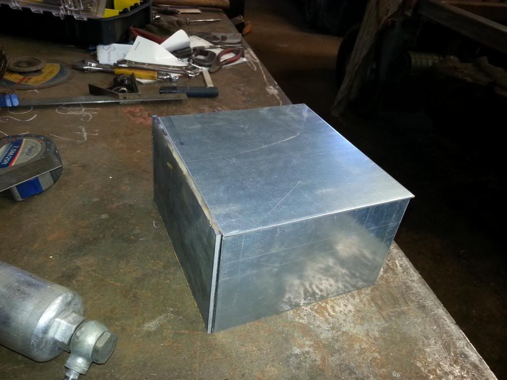

Bosch 044 with the sheet metal
cut to size for the tank

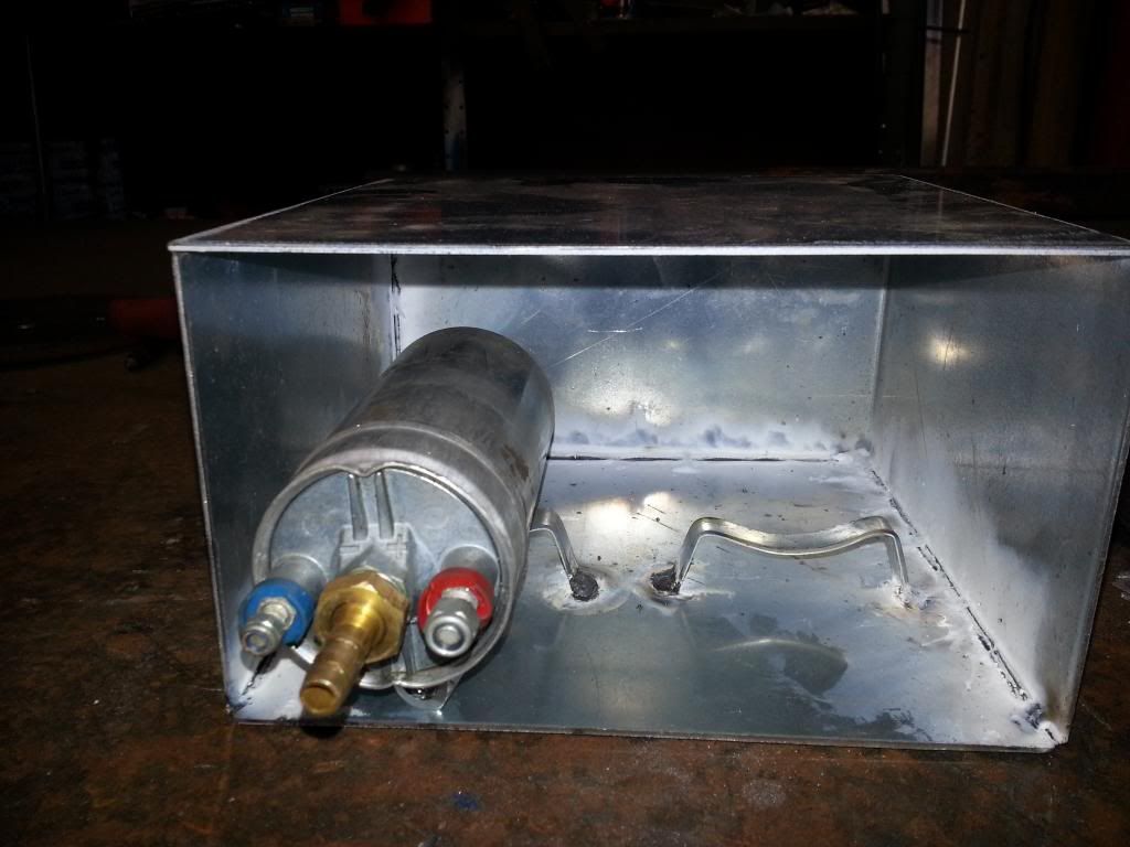

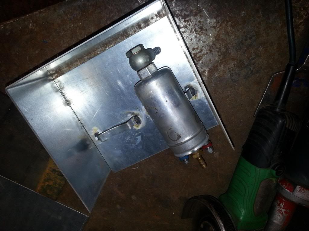

Then made some stands for the pumps to sit on and welded them on

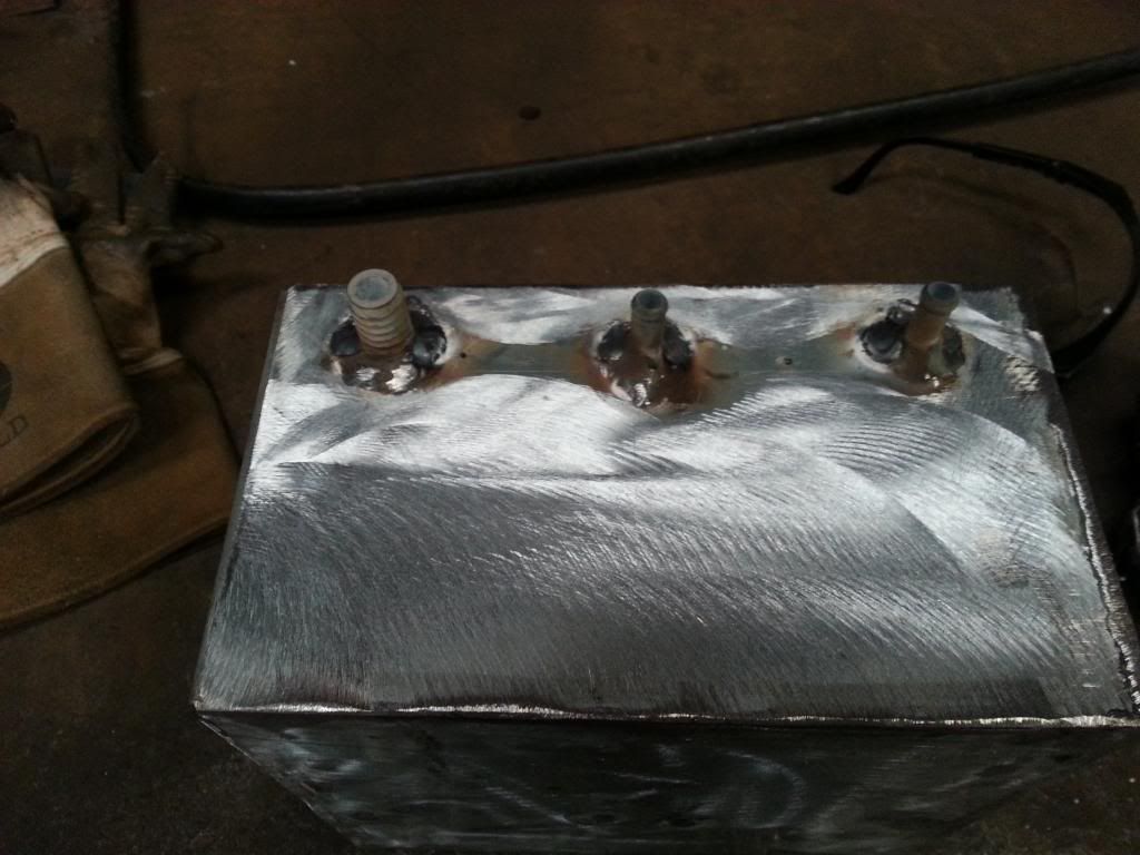

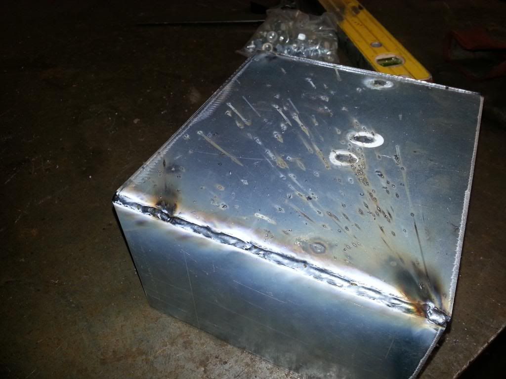

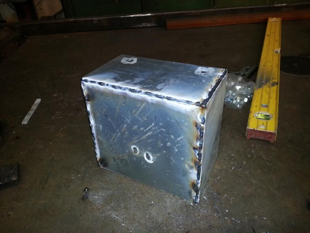

Welded up the tank

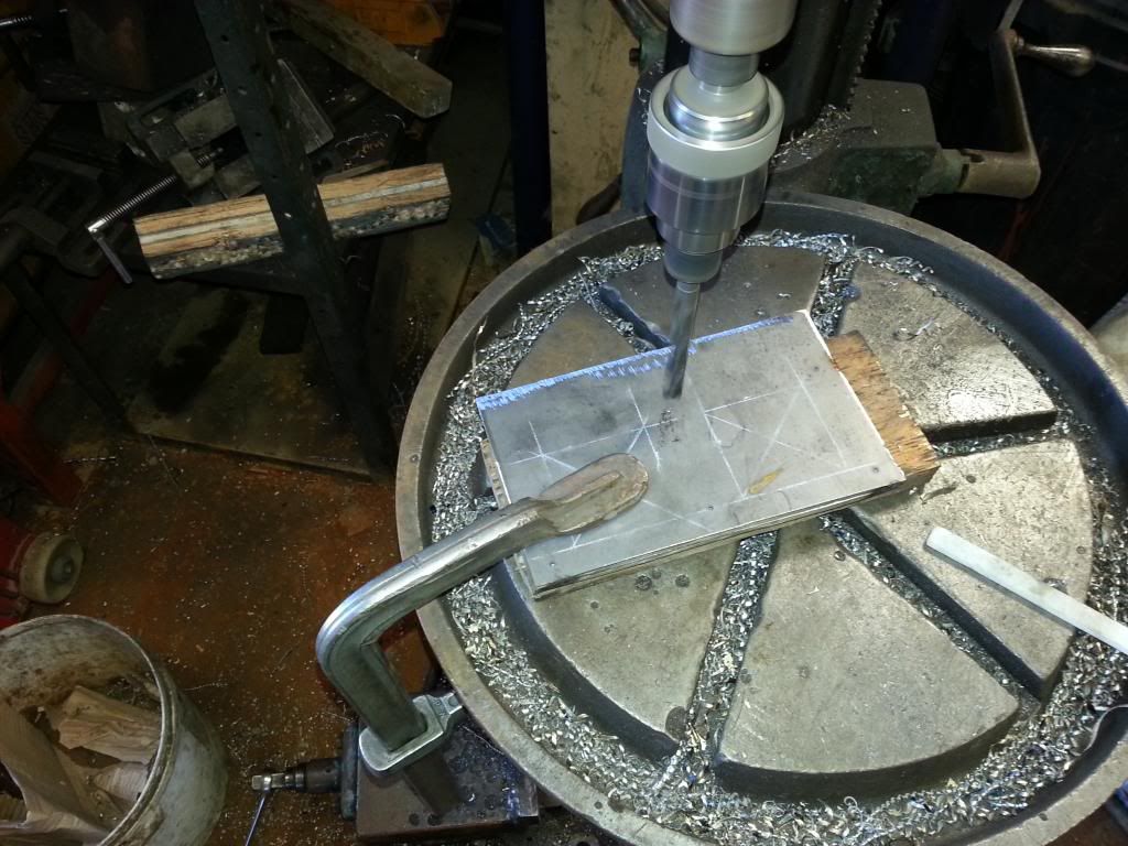

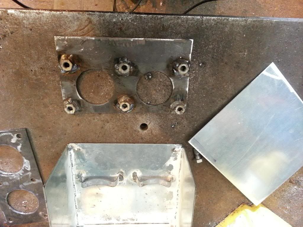

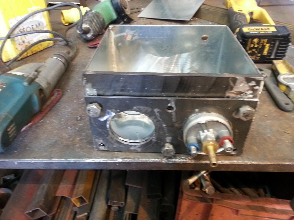

Then onto the front plate out of thicker material marked and drilled

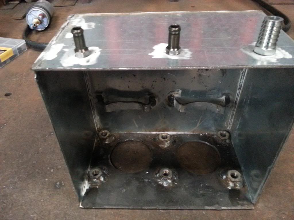

Cut out the holes for the pumps and welded bolts onto the back
I also cut and drilled a front plate which will clamp onto the front to allow to get the pumps in and out and keep it sealed

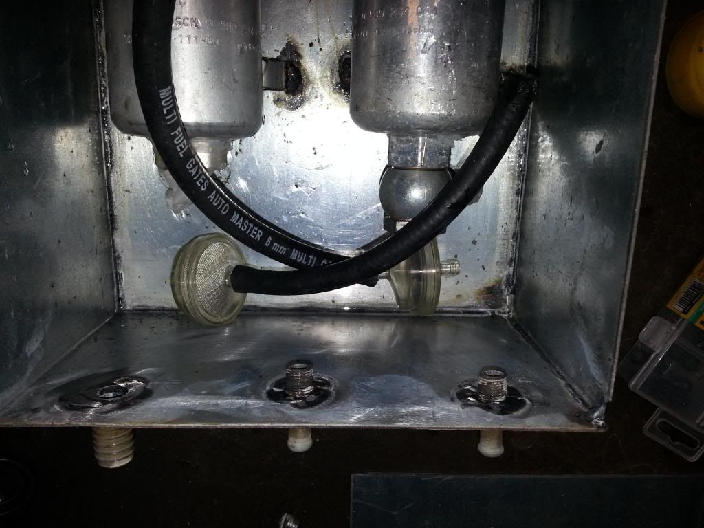

Drilled holes on the back one for a feed from the standard pump, one for the return from the rail and the last the overflow back to the tank.

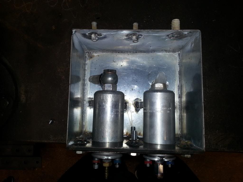

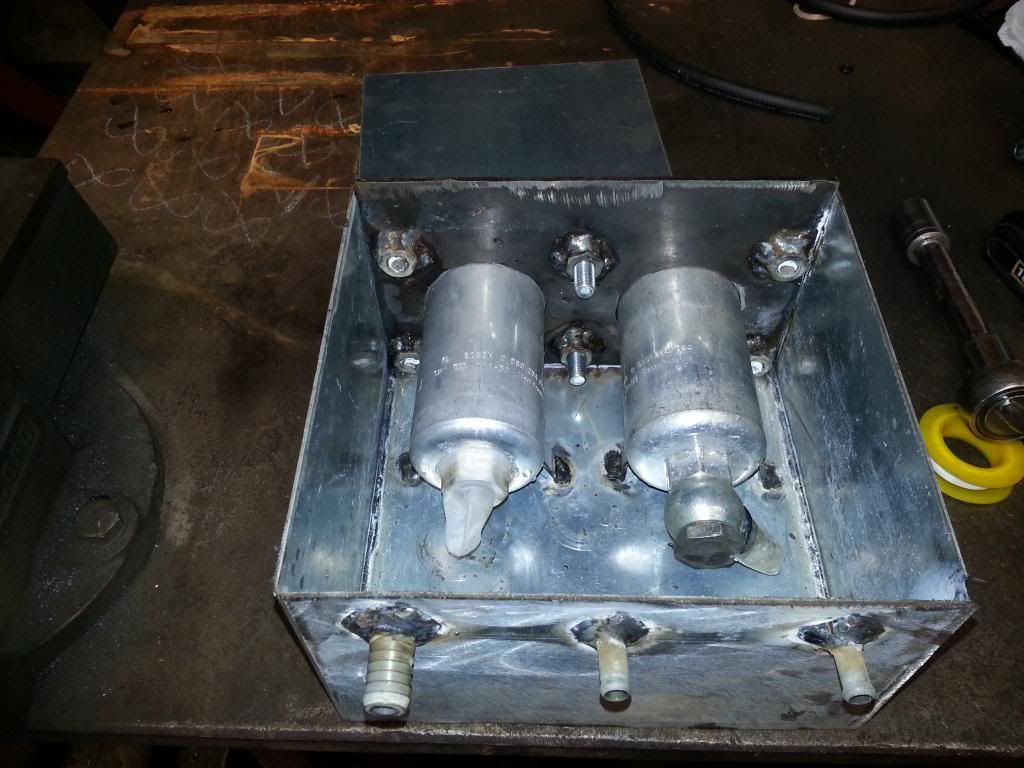

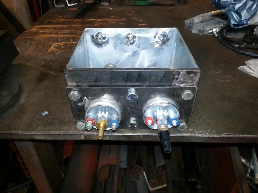

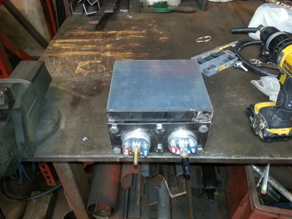

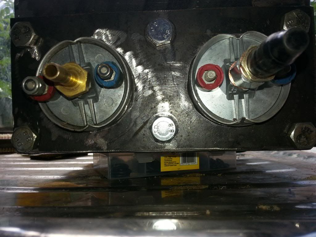

Both pumps in, how it will look

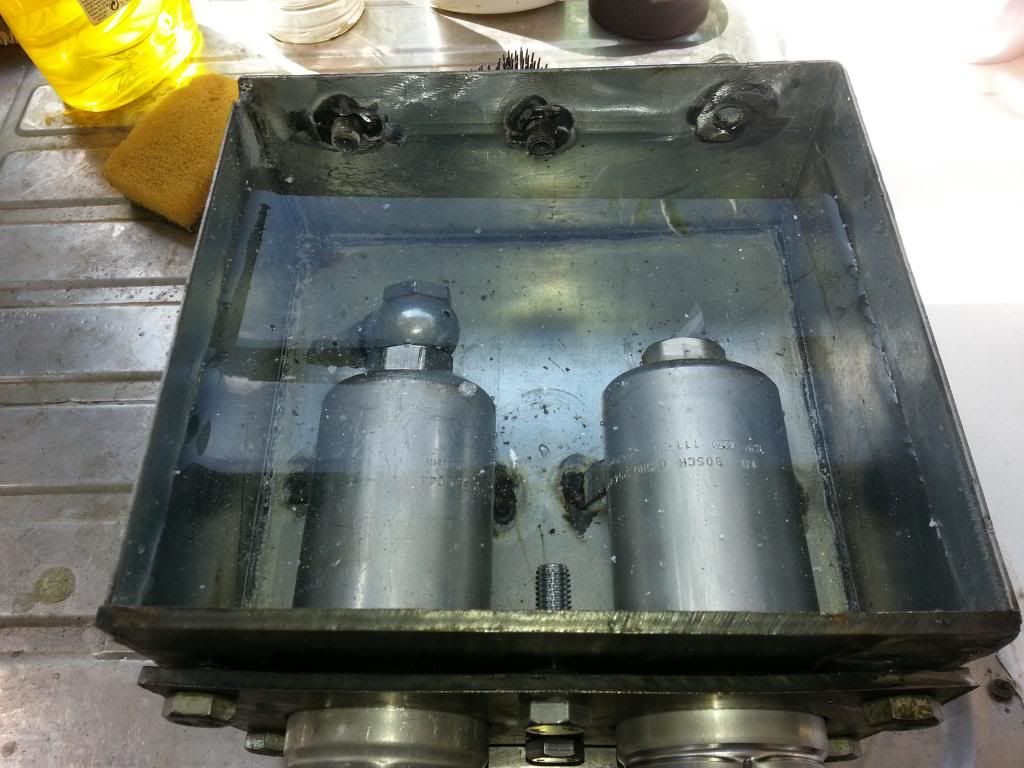

There is rubber washers between the plates and have used teflon tape on the bolts so should be air tight. Sealed it all in and filled with water to test. There was a couple of leaks on the tank but sorted now and no leaks at all.
Thinking about putting some pipes in off the pumps with filters on the end but unsure yet. Would be something like this
Either that or just leaving it with the banjo bolts
