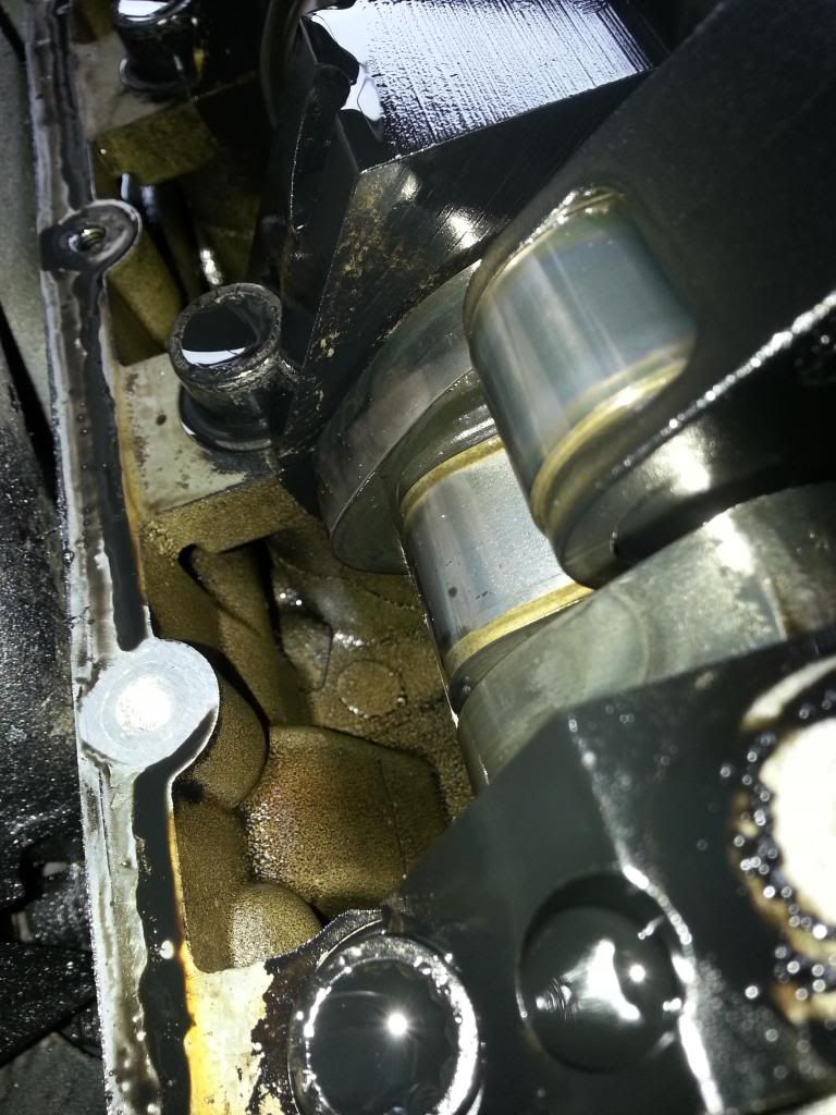

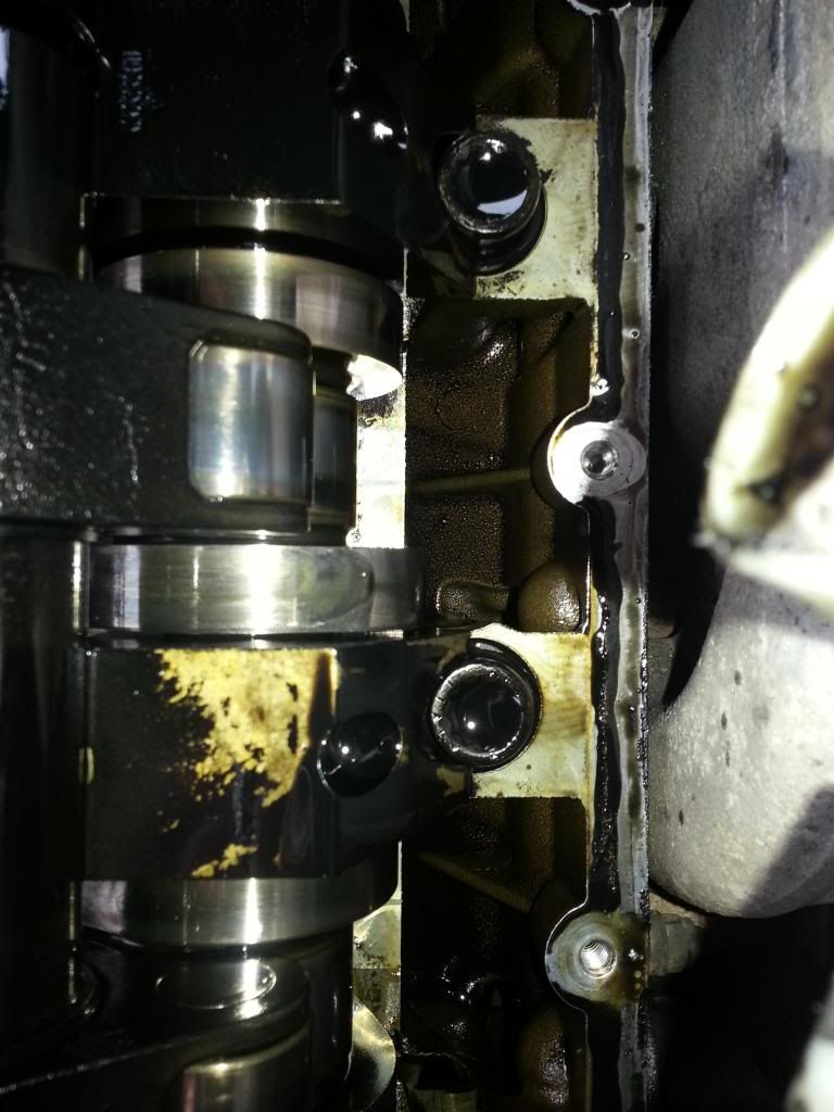

andygttdi150

Re: vw golf gt tdi 150 pd arl 2002 engine noise... NOW WITH PICTURES
Reply #6 on:
29 May 2013, 16:41 »
That one cam lobe looks worn and misshapen. Struggling to see much else to diagnose though!
Reply #7 on:
30 May 2013, 13:29 »
mine sounded just like that when the cam/followers let go
Reply #8 on:
31 May 2013, 15:15 »
Quote from: andygttdi150 on 29 May 2013, 13:17
f**ked!!!! You need a new cam and all the followers changed asap!
