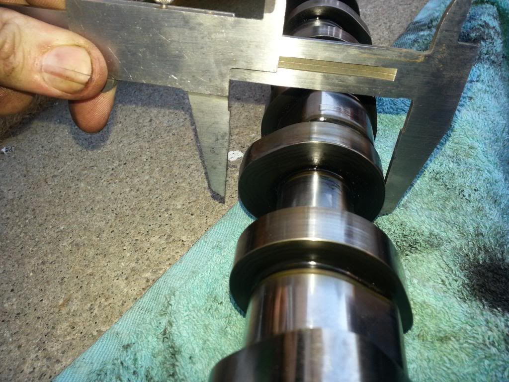

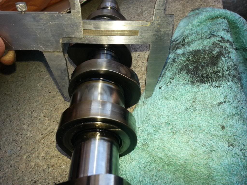

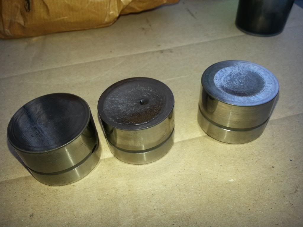

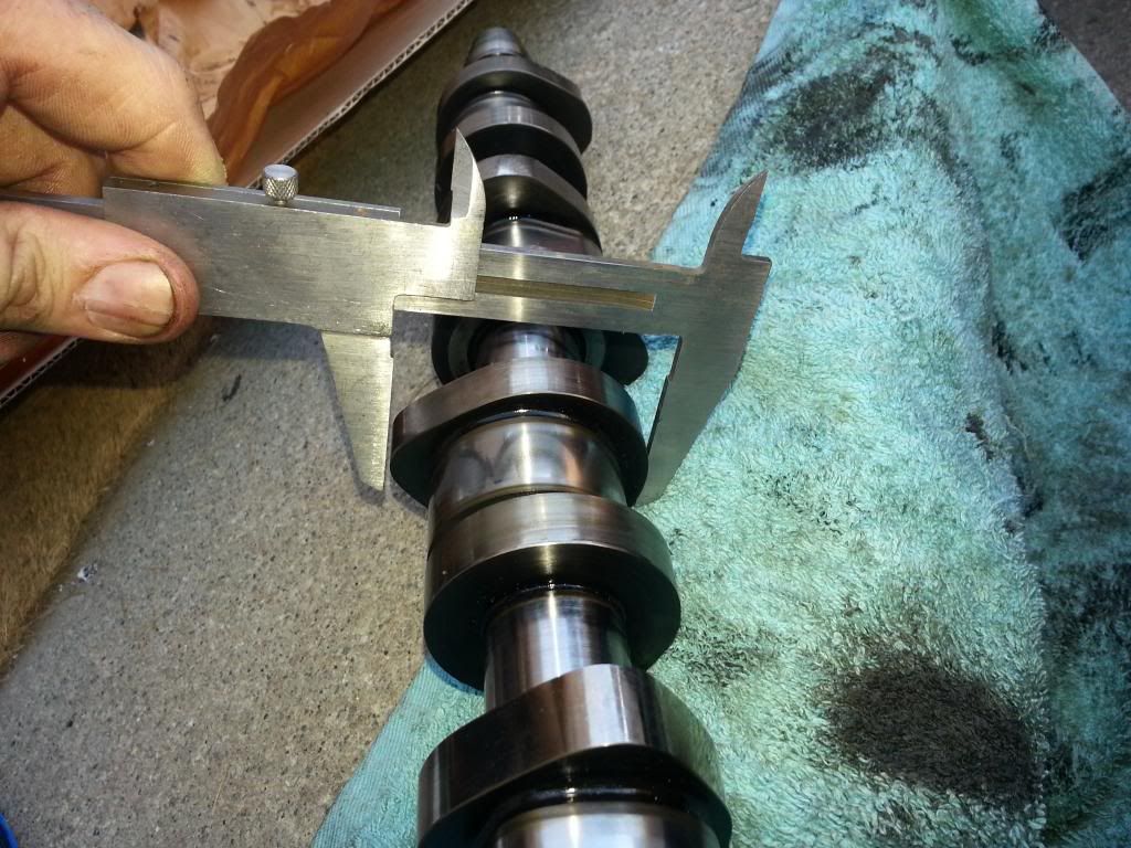

  I got heavy duty cam, lifter and shells for £185.
bolts £60, :sick:
 doing the job my self on Monday.
I will post once done

I think it was the cam!!!!
SORTED!!!
Thanx every 1 :grin:

Job took about 3 hours . did it myself.  :laugh:
I have the timing locking tools and pulley.
I must confess I had help from Youtube
http://youtu.be/V3XNNGpdu7w
