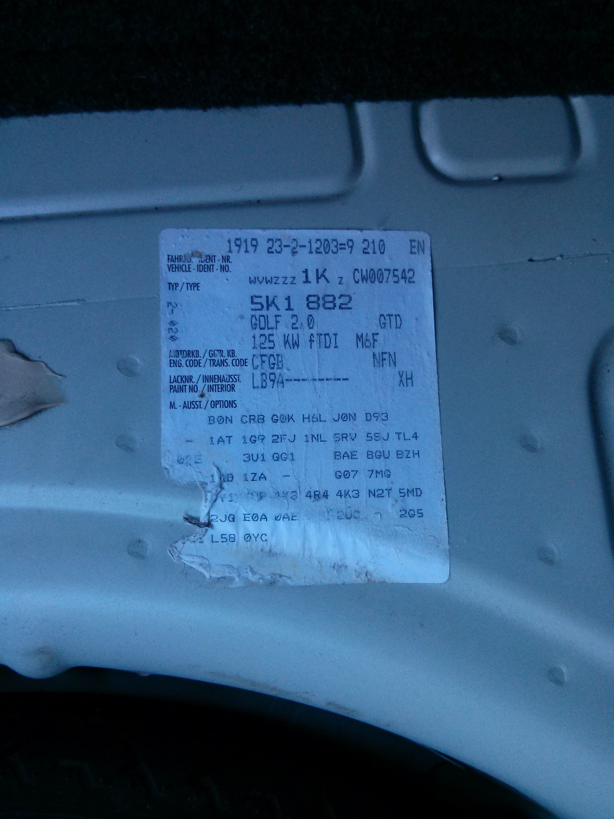

Anyhow, Im wondering if there are any guides or if someone can help me decode the information on the sticker in the boot to determine the features and model number etc. I have a picture of the sticker that I took today if that helps?

Think I may be able to answer some of my own questions here.
After doing some more reading around (maybe I should have put more effort in before posting here... der) I think I can conclude from the VIN that its an MY12 (year letter C), and although the label in the boot is damaged on one side, I did manage to extract most of the feature codes and found a website that decodes them. So that mystery is sorted.
Engine model CFGB which is the latest, or at least one of the latest.

I asked my dealer if they could fit cruise control. They said it would depend on when the car was built. Before week 45 of 2010 no problem. After week 45 of 2010 you need another module which is about £350 plus the switch plus fitting a coding.
If you write down all the groups of 3 characters of the Options sticker on the boot floor or have the first page of the service schedule open and type them into VW/Audi/Seat/Škoda Option Codes Decoder seperated by a semicolon (;) you will see what was fitted to your vehicle when it left the factory. There is an example on the intructions link you can copy and paste in there.

For my sticker, these are the codes I managed to extract:
B0N;CR8;G0K;H6L;J0N;D93;1AT;1G9;2FJ;1NL;5RV;5SJ;TL4;0BE;3U1;QG1;8AE;8GU;8ZH;1KD;1ZA;G07;7MG;4Y3;4R4;4K3;N2T;5MD;2JQ;E0A;0AE;2UC;2G5;L58;0YC
But as you can see from this picture, the sticker is a bit damaged so I cant get all of them off:
http://uk-svc.snnap.net/stuff/options.jpeg
But are you saying there is a second copy located in the service schedule? Where would this be located? (Ive moved over from Australia, and everything seems to have a different name over here, so excuse the confusion. :))

Tom, there should be a copy of that sticker in the front page of your service booklet.

If you write down all the groups of 3 characters of the Options sticker on the boot floor or on the first page of the service schedule
I've already said its on the first page of the service schedule.
Looking at the characters you have entered in looks similar to mine but you have.
TL4 - 4-cylinder diesel engine 2.0 l unit 03L.L
4Y3 - Storage box and safe box
4R4 - Power windows with comfort operation and circuit breaker
4K3 - Radio remote controlled central locking operated from inside and safe securing
N2T - Fabric seat covering
5MD - Decorative aluminum inserts
2JQ - Sports bumpers
E0A - No special edition
0AE - Front stabilizer
2UC - Sports version
2G5 - Filler neck module 1 without insert
L58 - Suspension range 58 installation control only, no requirement forecast
0YC - Weight range 3 installation control only, no requirement forecast
If you want to look at the list of Option codes and know what they mean then download VAG Option Codes
