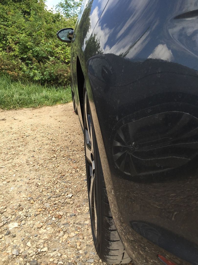

Took a pic to show just how bad the offset on the rear wheels looks. Fronts aren't too bad. But why aren't they the same offset?
All 4 wheels are exactly the same offset (ET51 for the austins iirc), it's just that the rear track width is narrower than the front, probably to do with clearance when fully loaded and VW playing it extra safe etc

Oh I see. That's weird and I don't like it!

Yeah it's rubbish! Been like that on Golfs since the mk3 days (and maybe earlier?!), first mod I did to my mk4 golf was 15mm rear spacers!  :smiley:
Getting the 'stance' right can be a funny old thing, I had 10mm front and rear on my mk5 ed30 and to me it was perfect as the car was lowered, same spacers on my standard suspension mk6 are perfect on the rear but I've left them off the front as they make the front wheels poke out from the arch line, lowered it would be spot on though!
