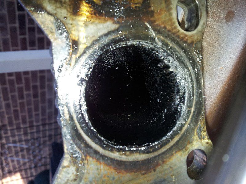

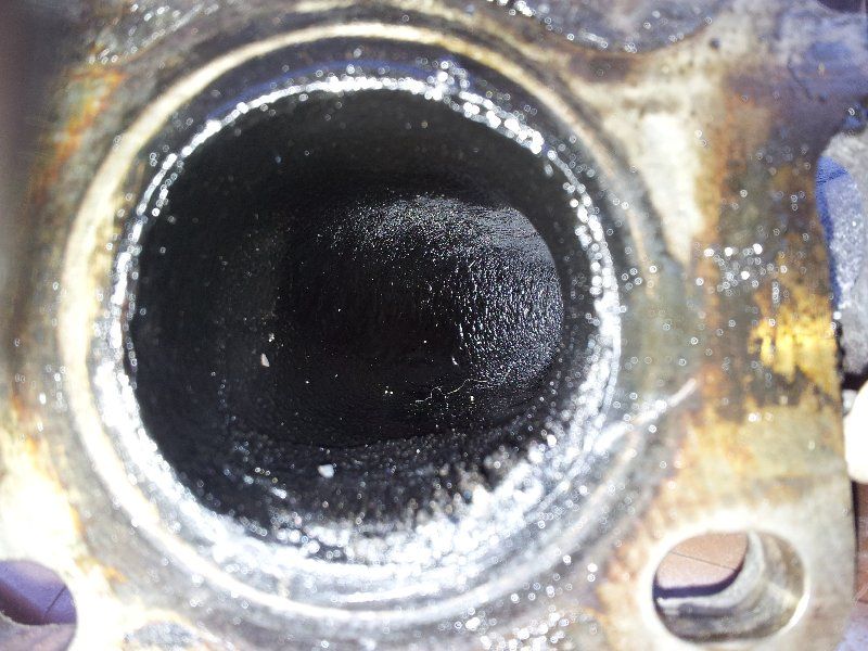

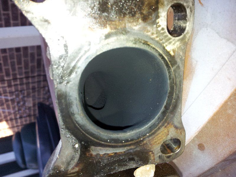

How ever thess picture may be of interest  exhaust port number 4 which has a oily tar build up and all the rest (including cylinder number 3 with a lower compression result)  have a dry carbon/soot build up.
Exhaust port number 4 oily/tar/wet
exhaust port numbers 1 , 2 & 3 are all dry/carbon/soot

I would say stem seals, they are letting a little bit dribble down which is then being burnt away quickly, you can do them with the head in place using compressed air.
