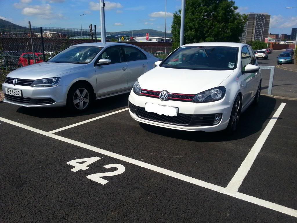

All better

Good to hear.  Just hope nothing has been marked or damaged in the hart transplant.

Great news.. If you see a madman in a 3 door GTI waving, it is just me  :smiley:

All parking spaces should have this much space either side.
