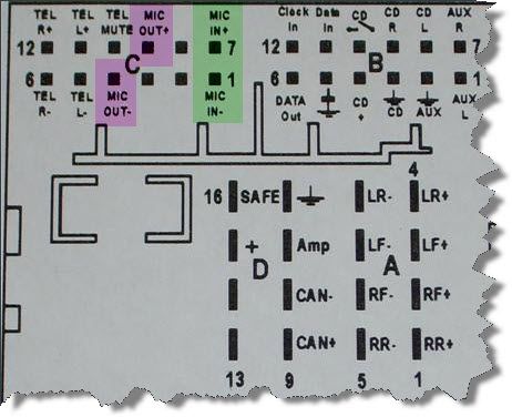

The green connector should slot into the back of the cars original quadlock connector that is pluged into the back of the radio.
I'm not 100% sure if this is right, but a bit of searching found this picture.

As Dubber36 says the green connector from the mic locks in to the Quadlock connector in the car. if I remember correctly it fits in the bottom right of the Quadlock connector, with the 2 wires on the green connector towards the middle of the Quadlock.
GPS antenna should connect to blue connector on back of headunit.

I've got a feeling that you push it in from the radio side of the connector and it just clicks in.
Going by your pic, have you run the wire up to the overhead console? What you should have done is passed it through the quadlock first.
