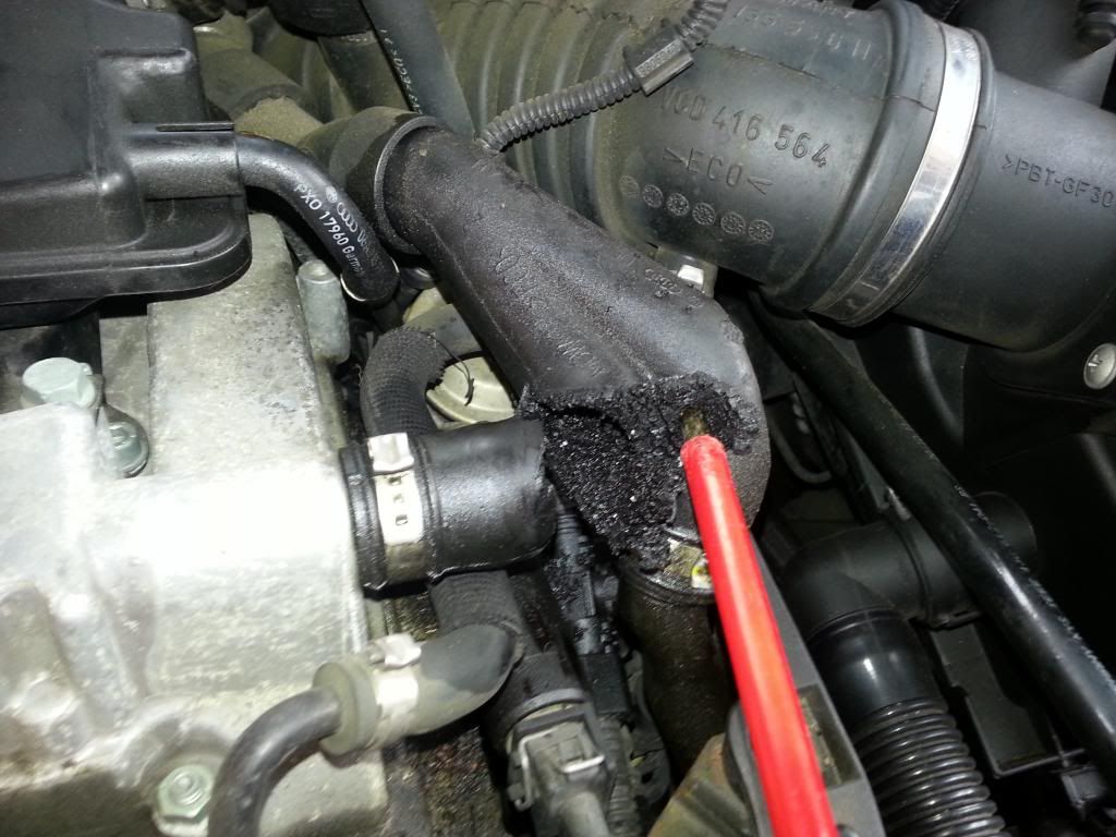

Right guy's think I've found the problem, took the big plastic cover off the engine to take a look at the coolant sensor and found my cylinder head breather hose completely split open  :cry:
Perfect time to fit a catch can :wink:

« Reply #9 on: 16 March 2013, 20:11 »
I wouldn't think that would put stop light on tho. As I just replaced mine and my stop light wasn't on
