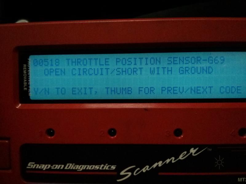

Soooooo, just to keep this updated for your continued entertainment...
Changed lambda sensor, which sadly didn't resolve the issue. Checked continuity of the wires and all good.
Then I started it again and got the following additional fault;
So, I've pulled the wiring from behind the manifold and although there are no breaks, there's a couple of suspect bits. Going to replace those wires and try again.
