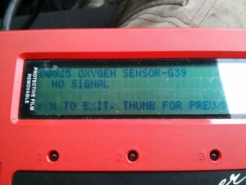

Ok it's running now, a combination of messing around with connections and some of Shell's finest (the fuel in the tank was pretty old) got it going.
Plugged the code reader in and I'm getting 'no signal from o2 sensor' .. damn. Will investigate that further tomorrow.

Presume this code (which is recurrent) is just lambda sensor (which is annoying as it's not that old), but does anyone know any testing I can do before replacing it?
roberto
Re: ABF lumpy, VW mechanic stumped!
« Reply #59 on: 22 September 2014, 00:37 »
try running car with it disconnected. you could also check all the wiring to it for breaks.
