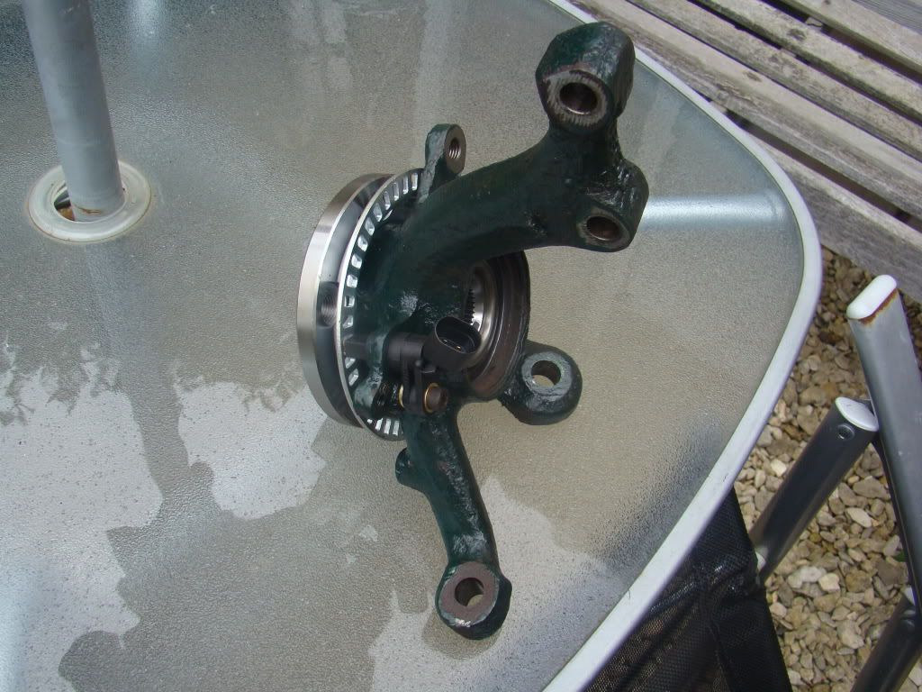

6 months ago I replaced the two front sensors and abs rings as I re conned both my front hubs here is a pic of one side.
So I think my question is Should I do a main ECU reset with battery d/c for 10 mins will that work or what else could now be the problem seems I have solved one thing and I am now stuck with another! Any help appreciated thanks in advance.  :kiss:

any ideas anyone? i will check the actual sensors incase i managed to buy to bad ones bit frustrating if i did!

The sensors should measure between 1k and 1.3k ohms.
You should have checked continuity of the pins after soldering, you may not have done the job right as the solder needs to flow.
Sound advice again.
Would say that the later over moulded sensors are prone to going, Ive had them last less than 6 months before all due to how they are made.
