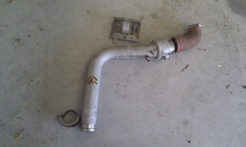

I did it the S3 way, I too didn't like the pipework over the TIP, it is awkward to get the piping lined up, but looks good when you do, you will need the K04 rear charge pipe bracket support with heat shield or the charge pipe will get ridiculously hot

« Reply #11 on: 07 March 2013, 12:30 »
when you say "you will need the K04 rear charge pipe bracket support" what is this and were would i get 1 from??

The bit above the pipe
You will need to get it from a breakers or somebody breaking a Leon Cupra R, 225 TT or S3

That support doesn't have the heat shield part attached it's just the bracket

it is what i was asking for :) and the heat shield i will just make my own up :)

I didn't use the standard (red pipe in pic)
I ordered a 63-51mm reducer at 90 degrees and it pushes the charge pipe more to the drivers side of the bay.
You will also need to get an LCR/S3/TT fuel rail as the standard 1.8T one will make the fuel lines impede/rub on the charge pipe
Yeah I got the same on mine
