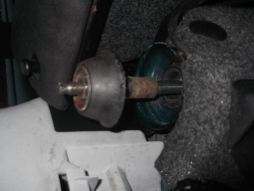

whats happened here?
13 February 2013, 17:39 »
[/img]

at first i was
then i was
and DONT DRIVE THE CAR .
at a guess the spring has snapped , or come off the lower strut mount.
it could take out your brake lines or could puncture your tyre.

New top mount required?

top mounts are new?

The shaft should not be able to pass through the lower part of the mount ,was the new mounts quality? febi etc

febi bilstein ones, renewed a couple of days ago

I have seen this happen to another forum member before, goes to the search
