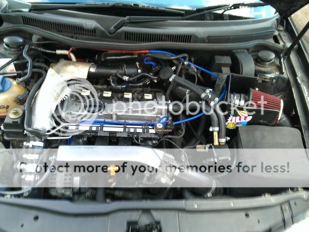

no didn't modify charge pipe, used the old tube that went from old smic to throttle body, standard fuel rail and all you have to do is unwrap the wiring from the loom and then 're wrap when pulled to passenger side I' 'll try and get some pics tomorrow

I removed all the silver stuff over the charge pipe, I was working on the car and by god does it get hot  :shocked:

I routed my toyosport pipework under my tip/induction kit on my aum gti when fitting my front mount.just needed to exstend some hosing for the dv and n76 take off.ill try get a pic up for u asap.
Had to cut a pipe or 2 of the intercooler pilework dwn slightly bit it worked well and is tucked in nicely.

Mine runs under tip, just don't go to low otherwise you get in the way of the gear link arm, all my pipes are heat wrapped as well so you don't notice them.
