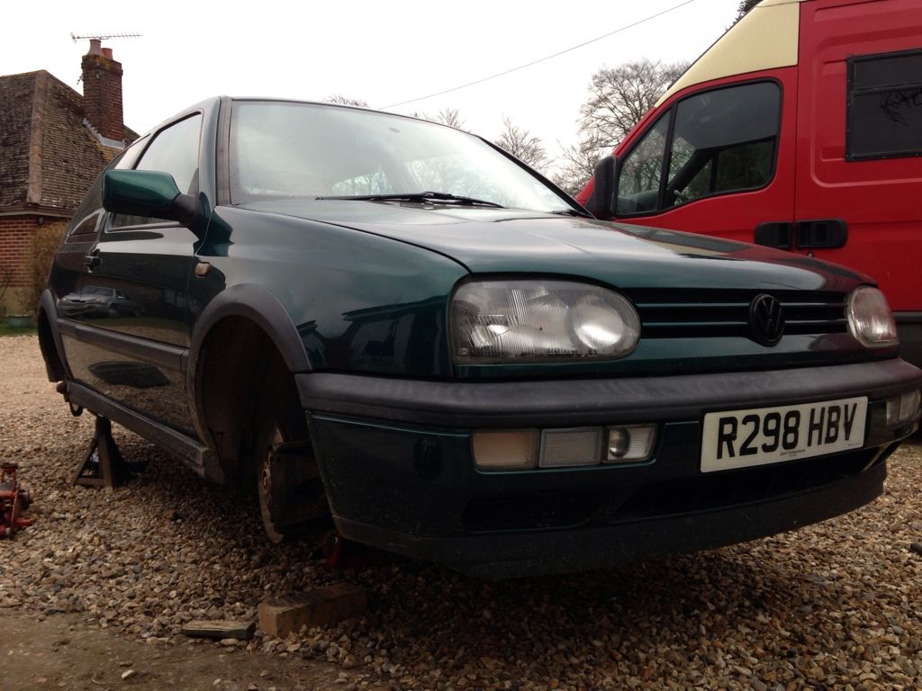

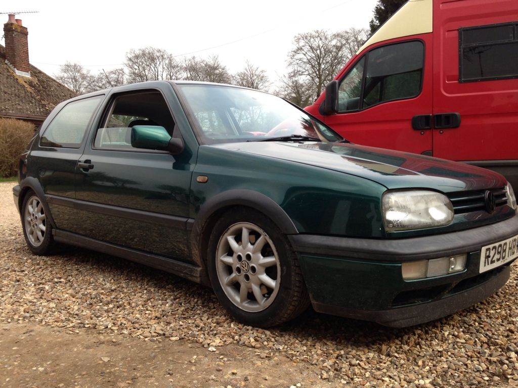

finally gave her more lows! was getting too much body roll (boat roll) round the corners so I went down by 20mm. I STILL DON'T UNDERSTAND though, set the heights exact all round from the rings to the bottom of the threads, and measured the strut lengths but when dropped there are slight variations in height each corner.. either the car is twisted ha or there's some bushing or something somewhere I need to replace. not got a clue on this.. need to get it set right so I can get it aligned though as the front tires are getting a bit camber'ey now lol
from this
to this
to this!
drives sooo much better now. you steer and it goes where you point it rather than getting that body roll.
