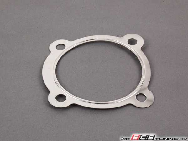

Does anyone know what the gasket looks like? I've just googled it but it came up with a double gasket?  :undecided:

« Reply #6 on: 13 January 2013, 12:13 »

« Reply #7 on: 13 January 2013, 12:24 »

« Reply #8 on: 13 January 2013, 12:28 »
Part number 1J0 253 115 A

« Reply #9 on: 13 January 2013, 12:37 »
Cheers mate  :grin:
