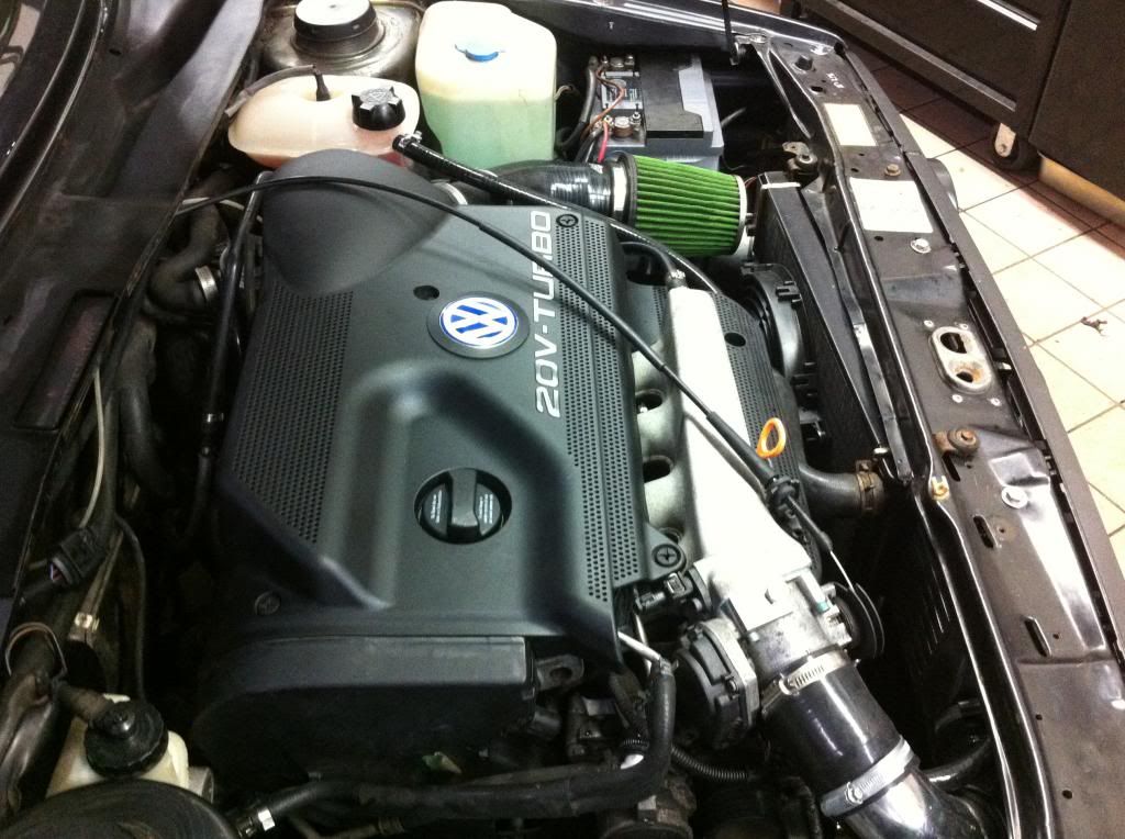

Got lots more done this evening. Changed the oil and filter, changed the fuel filter, fixed a blow in the exhaust were we had removed the centre box, Wired the fan up, fitted the induction cone with some new hose.
Engine as its stands tonight after running it for a while to make sure all is ok:
Need to make a bracket for the cone filter to attach to the slam panel. Just need to attach the loom in the engine bay then we can fit the servo back and make a servo pipe up.

« Reply #87 on: 14 February 2013, 19:19 »
cheers nearly done on the install.
Made a bracket to hold the air filter, speedo cable fitted.
Just a few bits to do then the engine bits are done for the time being:
Wire up alternator
Fix bloody exhaust blow
Find gasket for servo as theres a small leak and it makes an annoying hiss in the car
Fit new pedal covers
Tap thread in gearstick for gear knob
then re fit lower dash and centre console.
You never know by next week will be ready to give it a proper clean and start using it :whistle:
