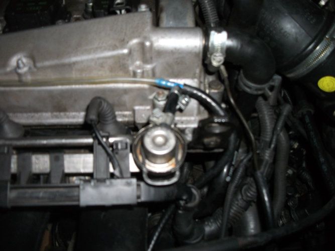

put mine in the drivers air vent . ran black wire to body for earth ,yellow to empty slot in the fuse board so it works with the ignition ,then ran the boost pipe through the bulkhead and plummed into the fuel pressure regulator with a t piece that should do it

Thanks for the reply. That sounds too easy is that all you have to do? Can anyone post a picture of the hose i need to plumb into im used to n/a petrol cars when i look under my bonnet my head pops abit with all the extra pipes and hoses

theres only one pipe that goes to the fpr t off that one

fuel pressure regulator / you can see the clear pipe going into the blue t piece . clear pipe goes to boost guage

Some top advice on here today  :rolleyes:
Diesels dont have what you have on your sh!tty petrol engines
Most tap into the EGR to intercooler pipe
Heres where I had mine fitted
http://www.golfgtiforum.co.uk/index.php?topic=89814.70
I had an EGR delete pipe which had the take off for a boost gauge fitted to it

Excuse my ignorance like i say im still learning. Why put it into the fuel pressure regulator pipe?
YOU dont.  Thats for petrol boost gauges  :wink:
Read my post above  :nerd:
