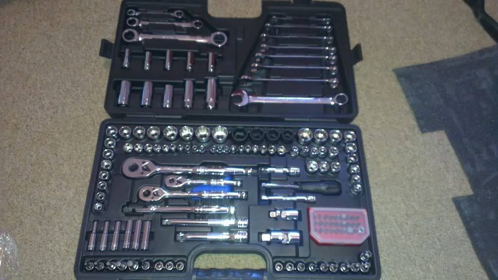

Picked up a Halfords Professional 150 pc socket set over the Easter weekend as it was on sale for £79.99. Seems great quality and a lifetime warranty. Used it for the first time yesterday, didn’t have much time after work so just changed my plugs (they were about 15,000 miles old) for some Bosch WR7LTC+ (Yttrium doped so longer lasting supposedly).

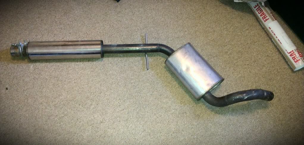

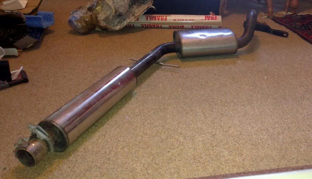

This also arrived today, a nice stainless steel exhaust centre section with two silencers which I got from Khare, via eBay. Paid less including delivery than he wanted for it collected as advertised on here so everyone is a winner!  Will hopefully fit over the weekend.

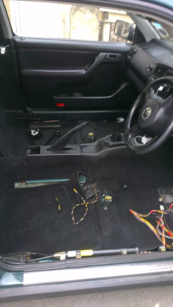

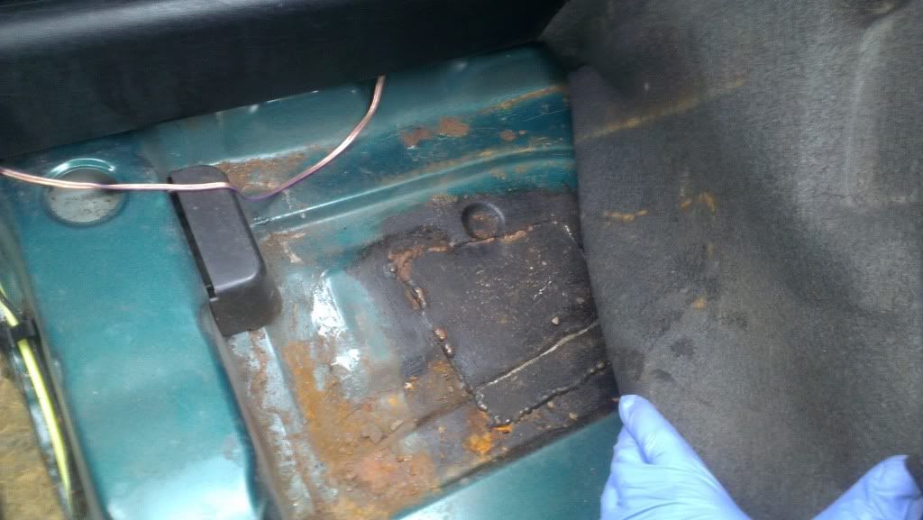

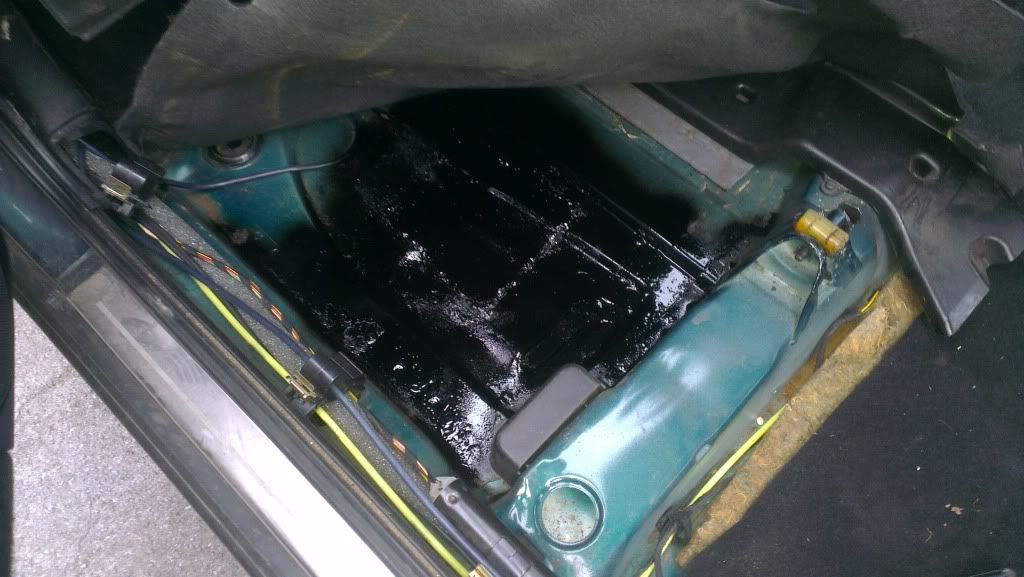

Had a fairly productive weekend working on the car. Managed to finally get around to installing my heated seat loom. It had been butchered somehwat upon removal by the previous owner, but with the help of Google I figured it all out and it's in and working. Whilst the carpets were up in the front I inspected for any signs of rot, thankfully there was none, though there was some surface rust where a patch had been welded in and not painted or anything! So I sealed this upo with some bitumen-based underbody sealeant from a spraycan. Also checked the underneath and wasn't surprised to see again it had just been left as bare metal! So a quick wire brush, some rust inhibiting primer, and then more underbody sealant.

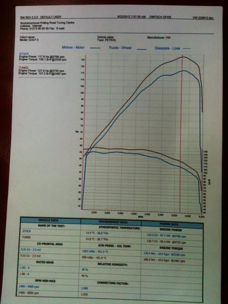

Whilst I had the clocks/fuse  box out I figured I may as well swap in the remapped ECU I bought off eBay. Paid £80 which included the immobiliser box and keychip so was a straight swap, easier than buying a chip and then paying someone to solder it for me. The guy had paid £350 for his remap(!) and supplied this rolling road chart. Car feels a bit more responsive so for the money I paid it was worthwhile.

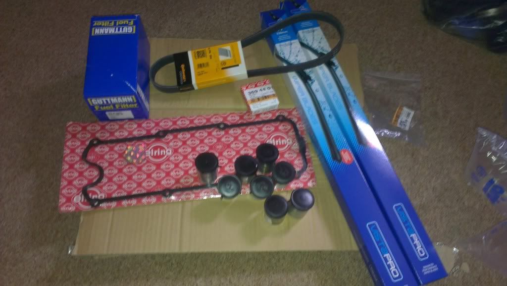

EuroCarParts had a big sale on over the Easter weekend so bought  load of bits I needed. Fuel filter, new flate wiper blades (ECPs own brand Vista Pro - seem really good so far), alternator belt, cam seal and cam cover gasket, and a set of hydraulic cam followers for when I install my new cam.

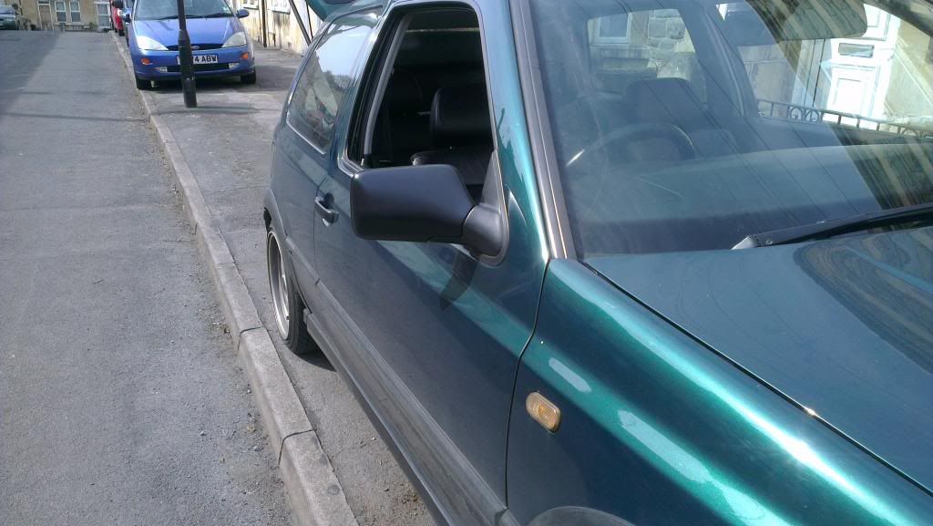

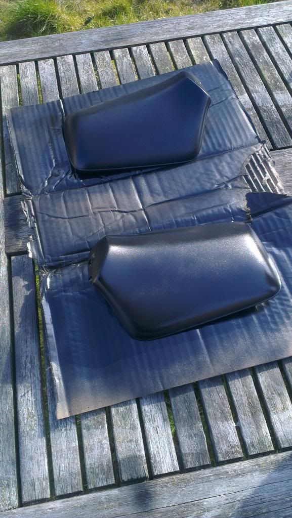

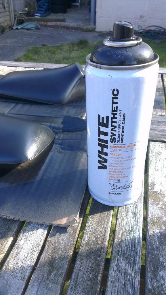

Finally I was bored and decided to spray my wing mirror covers black. Just gave them a light sanding and sprayed with Montana White gloss paint, goes on so well and is almost impossible to make it run, sticks to anything, I love it!
And here they are fitted.

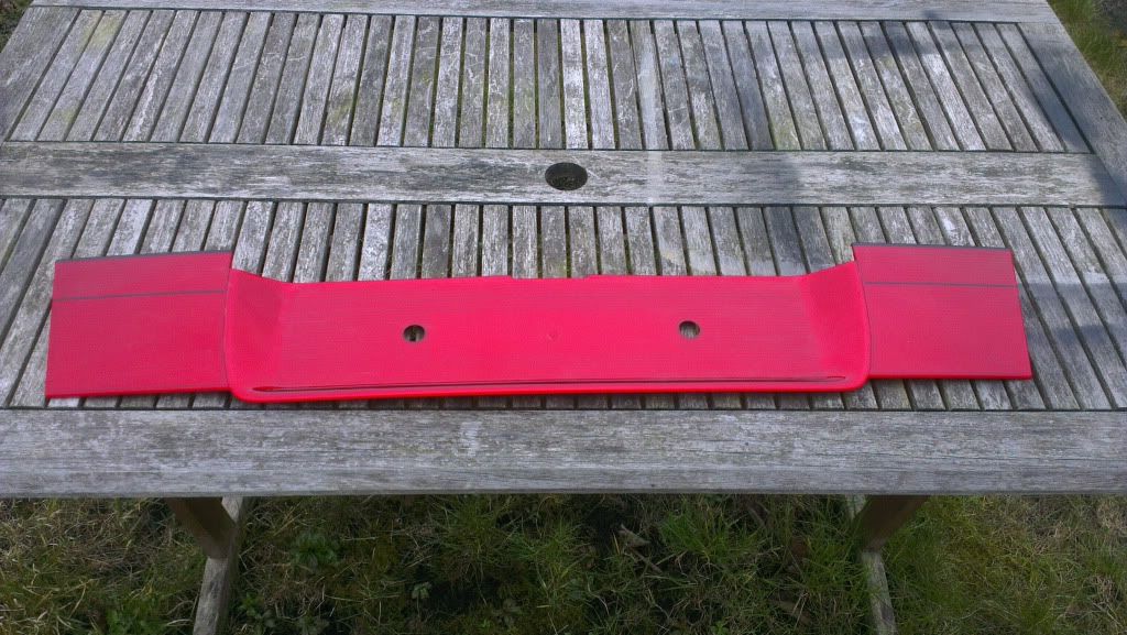

Got something awesome through the post today via eBay.de, a bit polarising but I love it...anybody want to guess what it is?

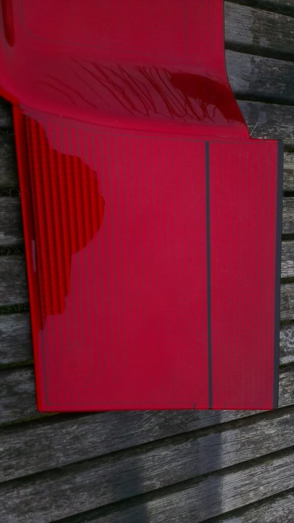

Home and unpacked, just gonna give the car a wash so will take some photos with it on in better light tomorrow morning. Brand new and only cost 50 quid including postage from Germany
