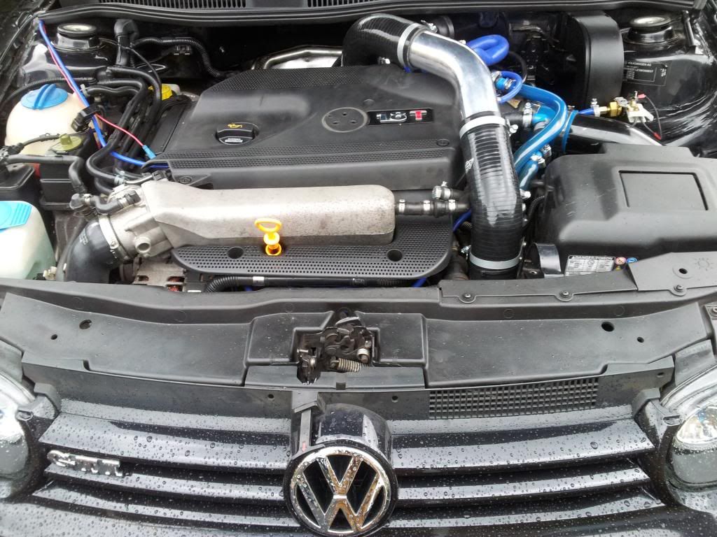

Rio chap, struggling to reply to your pms, so il post in here  :smiley:
this was the outcome of my 45* pipe
how it sits
I can see why nikki only managed to get 231bhp from my set up now  :shocked:... Old VS New

Nice one Chris that looks the nuts, that sits perfect did you use a 90 red. Off the core on the r/h/s and a 45 red off the car on the l/h/s? Also what cooler did u use
Cheers bud really pleased with how its all come together cosidering there just bends and lenths.
Im running a toysports cooler not as big as the welly cooler, but Im running  devils own Water methanol injection kit so my intake temps are going to be insanely low compared to the welly cooler anyway.
For the cold side Im using my original hard pipe as it was already 2.5" as apposed to the hotside which was 1.75"  :rolleyes:
cold side
Hot side from cooler; a 63mm 90* silicone bend, 63mm 90* alloy bend, 63mm 90* silicone bend, 63mm 300mm straight alloy coupler, 63mm 45* Silicone bend, 63mm 45* alloy bend (with n75 & dv take offs), 63mm 90* silicone, 63mm alloy couple 100mm long, 63mm-45mm Silicone reducer onto the turbo outlet.
hope that helps  :wink:
