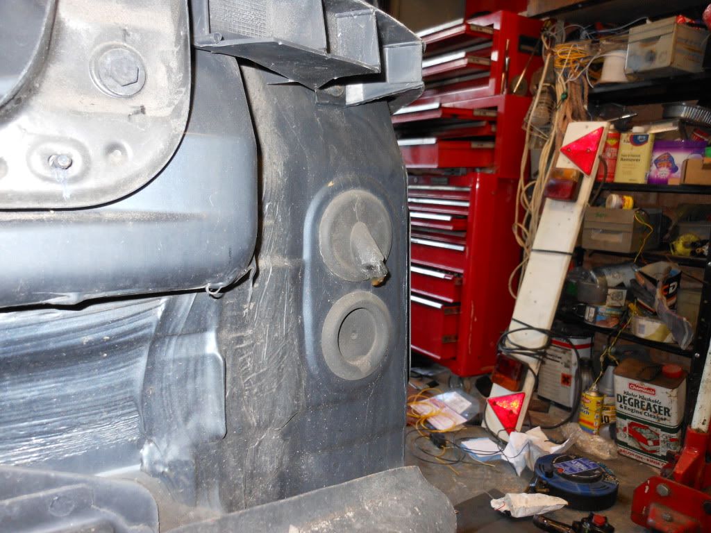

Give them a squeeze just like tweaking a nipple..
In-between the to hinges on the front door and behind the rear bumper.
Look like this
